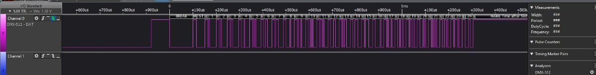

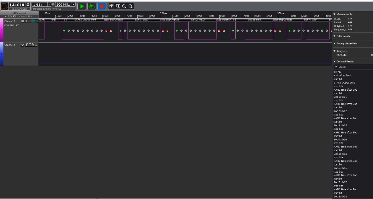

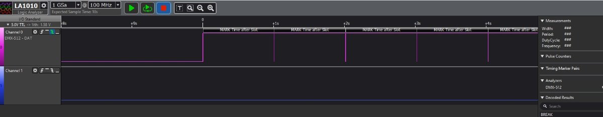

Hi Martin
Looking good. No issues on my analyser
I modified to wait one second before repeating for clarity.
Attached show captures.
In the last one you can see the data incrementing :)
