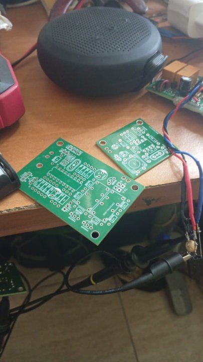

As long as an encoded signal can be transmitted and received without reading errors... that’s excellent. It’s just a matter of being able to get them on Amazon, AliExpress, Alibaba, etc.; I’ve designed some PCBs and sent a few out for fabrication to test them.
Saludos
Saludos
- PCB1.jpeg (46.76 KiB) Viewed 5627 times

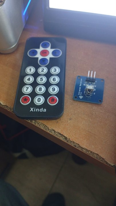

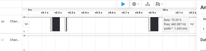

Hi, I'm like a kid with a new toy;
I found a transmitter and receiver in my Toy box—according to my checks—operate at 38 kHz. I displayed the signal received by the RX when pressing the "0" button on the screen. How can I get the PIC to decode the signal and identify that I'm sending a "0" with the TX
The IR remote and 1838 receiver are inexpensive and very commonly used with Arduino.
I believe I noticed the encoding format was NEC (though I’m not entirely sure), but basically, there shouldn't be any errors in receiving and decoding the number.
Enrique
Enrique
- CERO 0 BOTON
