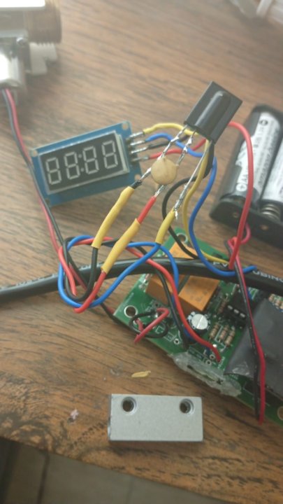

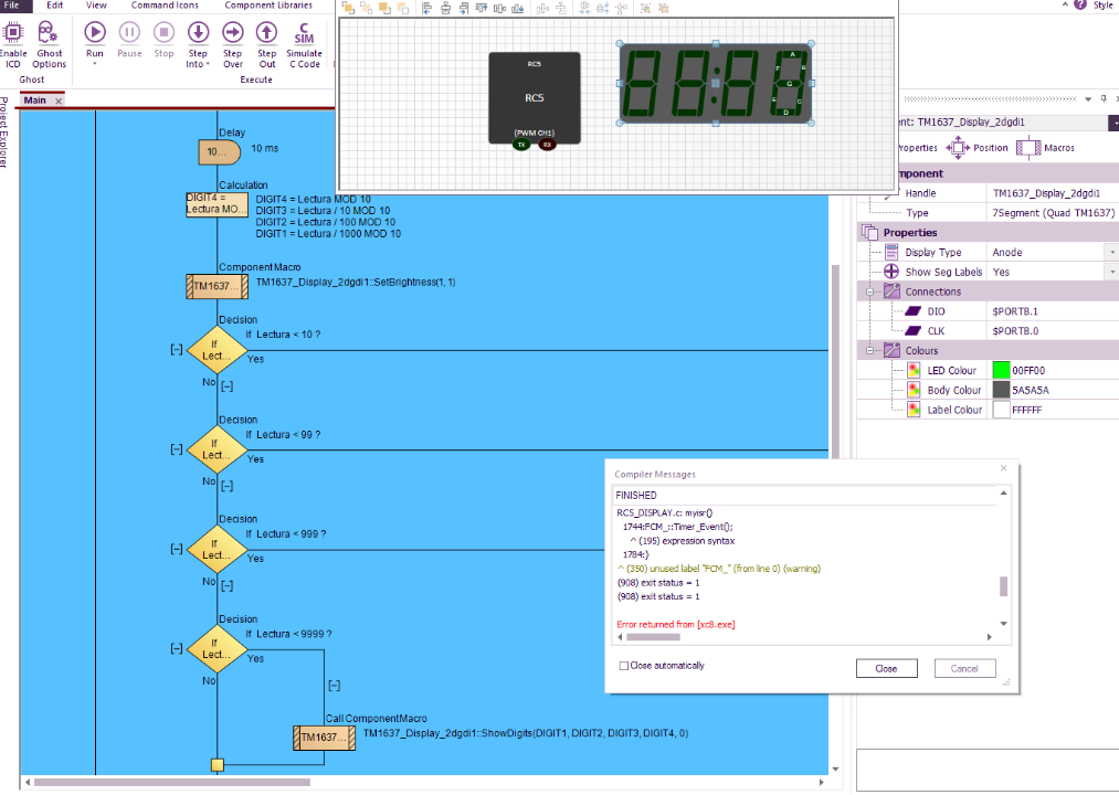

I wrote a simple little program using a TSOP31236 (36 kHz) and a 4-digit TM1637 display to show the reading sent via RC5_TX and RC5_RX, but I can't get the program to compile; it throws an error related to a timer.
I think it's a bug in Flowcode.
Enrique

I have just downloaded your chart and it successfully compiles to Hex for me.
I'm using latest FC11.

Man, I was really struggling with this—I even swapped out every single TMR, but it kept throwing errors over and over. I just compiled it, correct; for a moment, I thought you might have an update I didn't have. I'm going to test it on the hardware right away.

You may have had something else causing the issue that you resolved without knowing?
Hopefully it compiles to target for you.

I just fixed the flowchart. It starts by testing that the display is working correctly, then enters a loop waiting to detect an RC5 TX signal; I connected an LED to pin A2 as a detection indicator, and the display itself shows the reading. However, the display doesn't respond at startup, and once it enters the loop to wait for the RC5 signal, neither the LED lights up nor does the display turn on—it remains off.

One observation: the display turns on in the simulation, but not in the hardware.

I tested it with a brightness of 1; let me switch to 7 and test it.

not working
