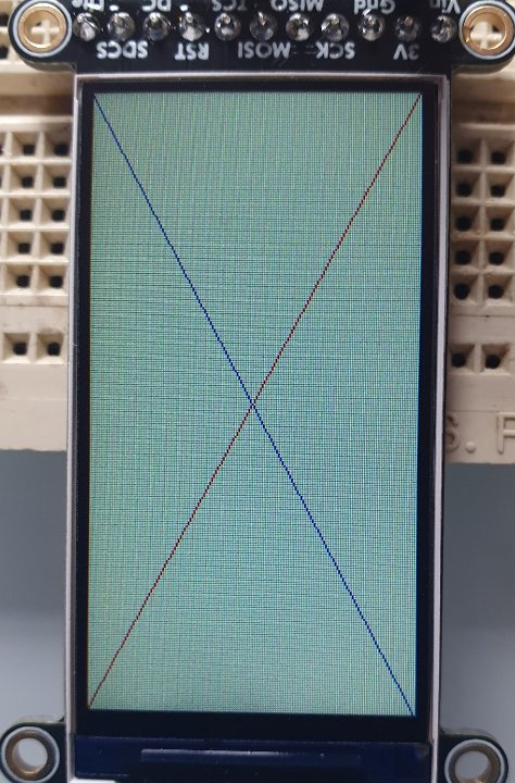

The plot thickens. I can get the attached, which looks as advertised, with the following changes:
- swap the X and Y pixel defs in the display properties, AND make the x - number slightly larger than the display datasheet values. Display x = 320, y = 170, set properties to x = 205 and y = 320;
- set display orientation to 90deg CW (parameter = 1).
I tried all the other orientation and X-Y permutations, they all give wrapped line displays, with or without the hash area.
