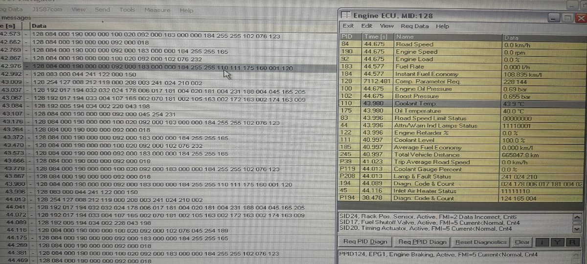

bios33 wrote: ↑Mon Jan 22, 2024 11:55 pmHi!
Here is a fragment of data taken from uart via USB/RS485, you can see there that the packet starts at 0x80 if in hex and in the next screen from special software, j1587 Navigator, from Volvo, and there you can also see that the beginning of the packet starts at 128 in hex 80 But when all the blocks and other packages appear on the network, for example MID 144, MID 130 and so on, now I only have MID128 on my desk.
I can't connect external COM to FC, I think it would be easier that way
Here is the monitoring of communication between control units in my tractor
- 1000007171.jpg (360.88 KiB) Viewed 7435 times

Re: Protocol j1587
The length of the data blocks seems to vary - for example there are several starting 128, 84 with differing lengths..
Iain, kindly gave a link earlier - it looks like it is not as simple as waiting for 128 then reading a fixed number of bytes..
Re: Protocol j1587
Yes, the length of the frame is always different and the beginning always begins with the name of the control unit (128 is the MID engine) and at the end of the frame there is a checksum byte. But there are other MIDs, for example the 144-central module
