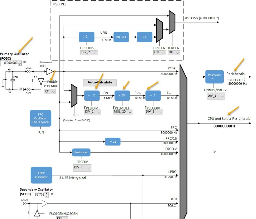

As a test I used MPLABX and Harmony to generate me the clock settings and it running fine on the mikroE EasyPIC Fusion Development board
XT = 8MHZ
Clock speed 80MHZ
the Harmony configuration
The same settings in the MikroE PIC32 Compiler Runs fine aswell
settings tested in 2 compilers and tool chains with no issue :D

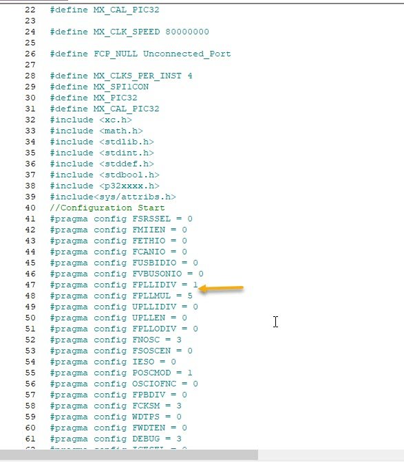

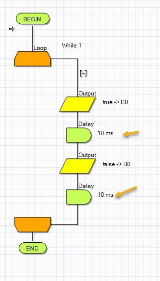

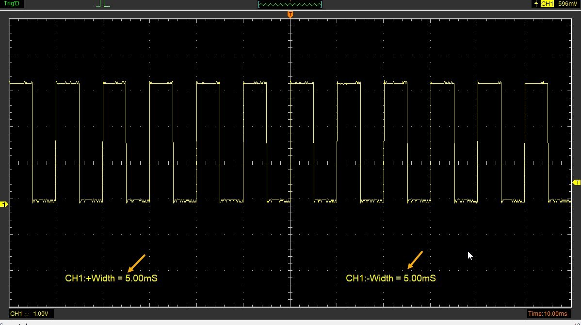

Running the same settings in FC the clock speed is faster as it should be ,

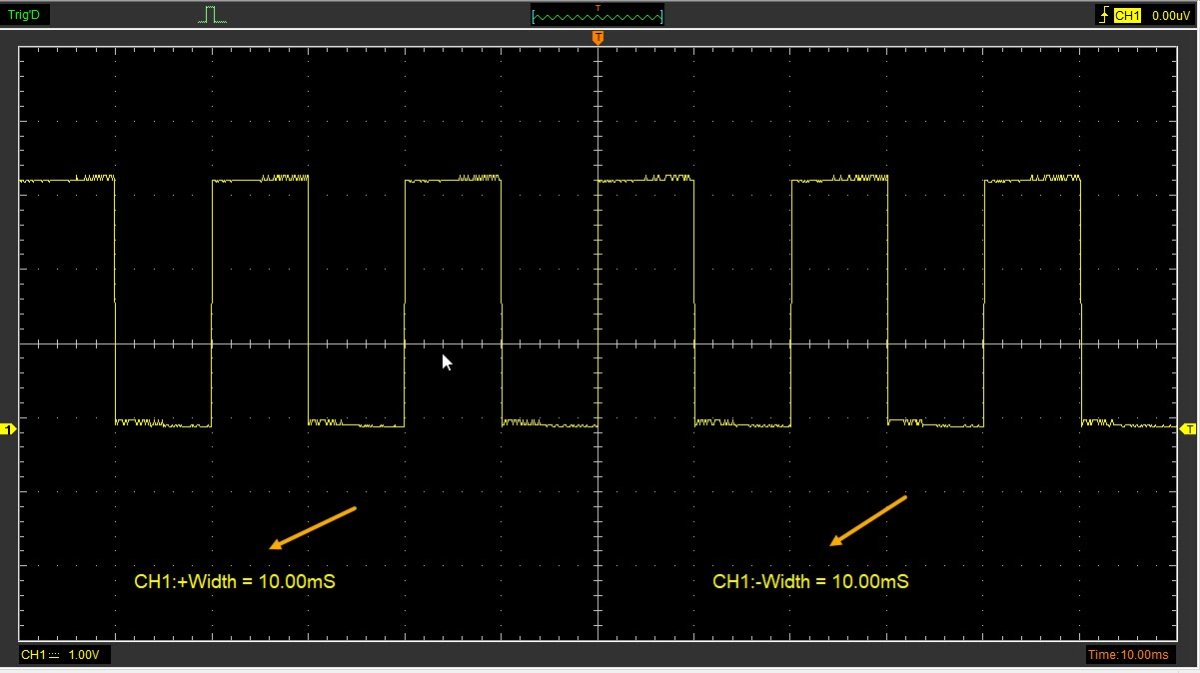

I set a led on 10msec and off 10msec so an period of 20mSec effectivly as you will se below the ON and OFF timnes are 5mSec
totally incorrect
The configurations below

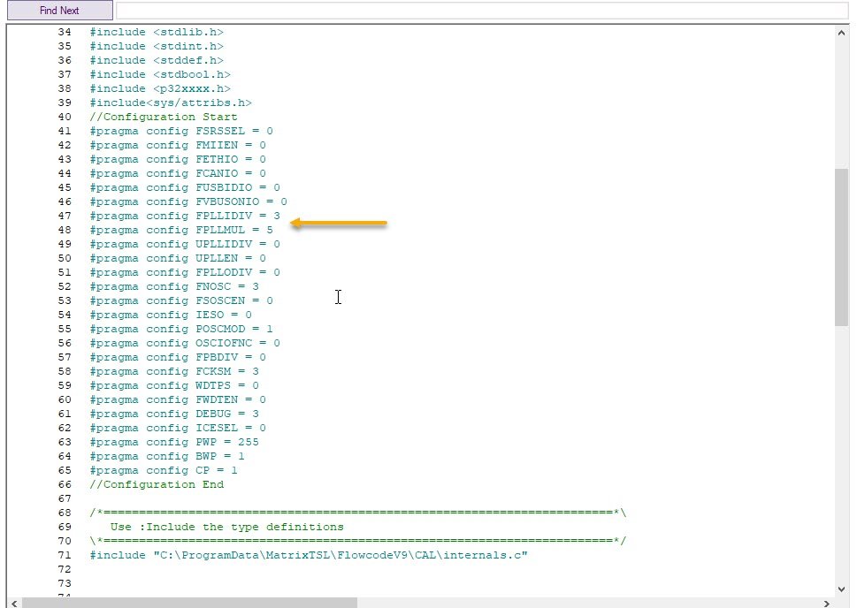

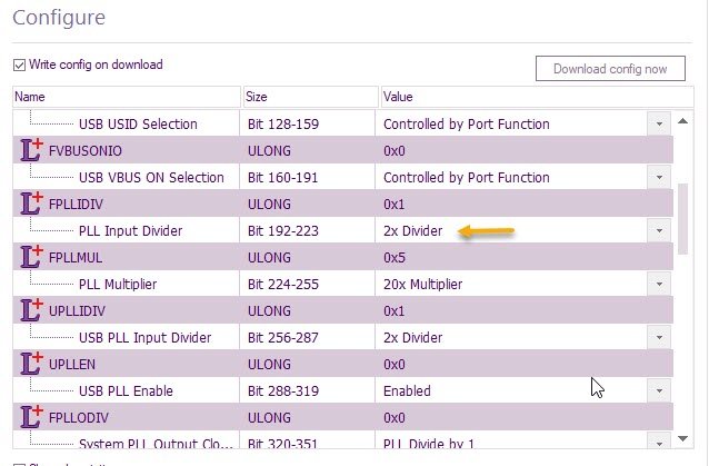

Notice the generated code the FPLLIDIV is set at 1 (I canot judge that this is correct or not) just showing what I see and the multipier is 5 which is x20

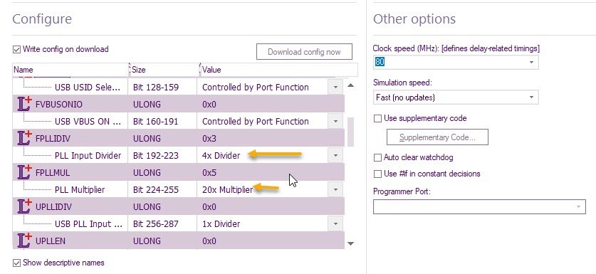

If I set the FPLLIDIV to x4 it causes the the timing to be 100% correct and the code generated show a value of 3 for FPLLIDIV
see below
in all cases the Peripheral clock is set at Pclk/1(div by 1 )
I attatch the project as well however in my humble opion there is an isse with the pic32 config settings in FC

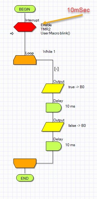

After a few more experiments

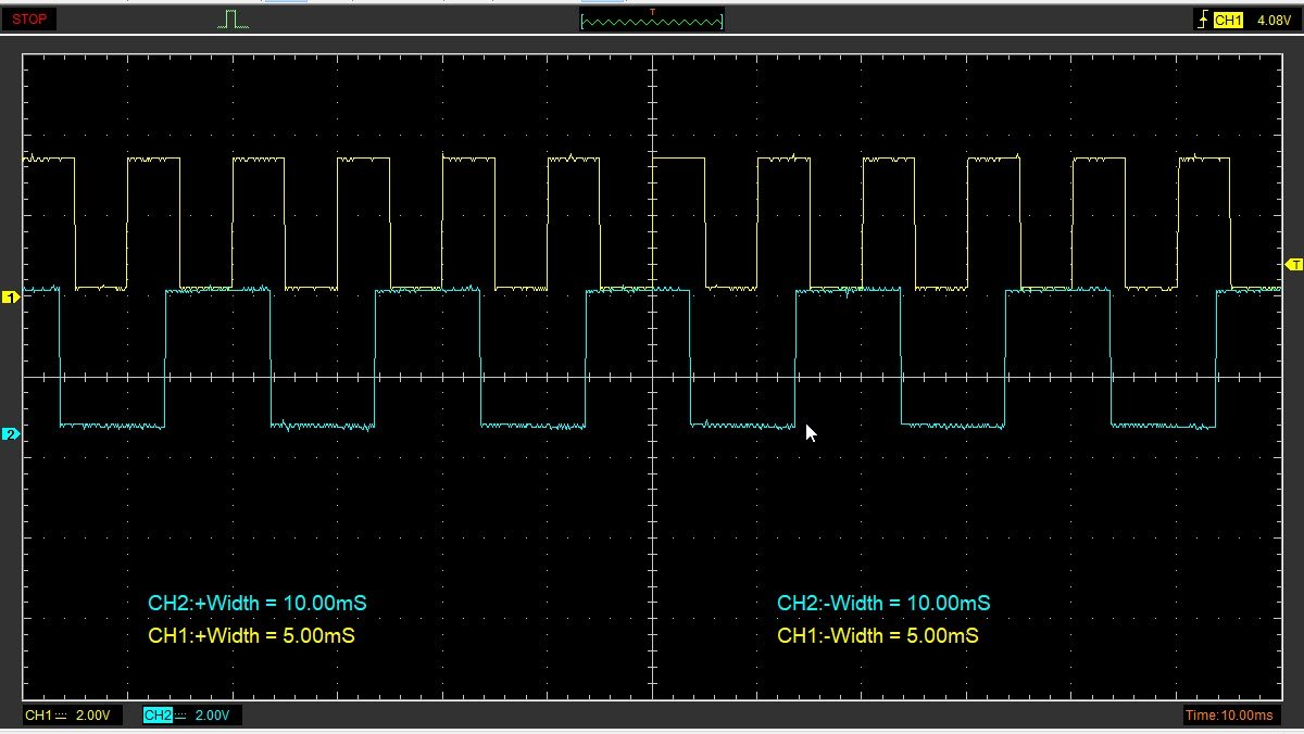

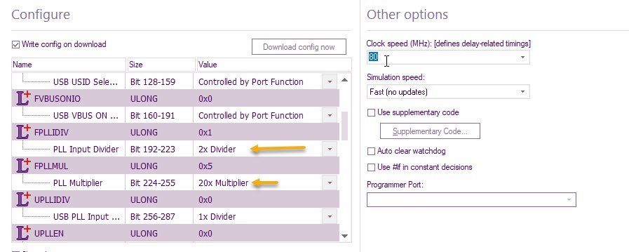

I set the FPLLIDIV to x2 as should be and configure Timer 2 Interrupt for 10mSec and then toggle led on RB1 and leaving the Toggle of LED on RB0 in the main loop controlled by the Delay component.
The interrupt fire exactly on the 10mSec and the delay timing is way off ,
This seems that the PIC32 is running at the correct clock speed as it si configured for however the delay calculations are wrong below a print of the timings and the code file.
CH1 delay timing control and CH2 is timer 2 interrupt controlled
Would you agree with me that it seems there is a problem with the delay component , :D please shed some light on this :D

The FPLLIDIV set to /2 should be a value of 1 so that is correct.
The PIC32 devices have internal clock dividers and that is probably what's causing the timing issues.
What is your FPBDIV config setting set to?
