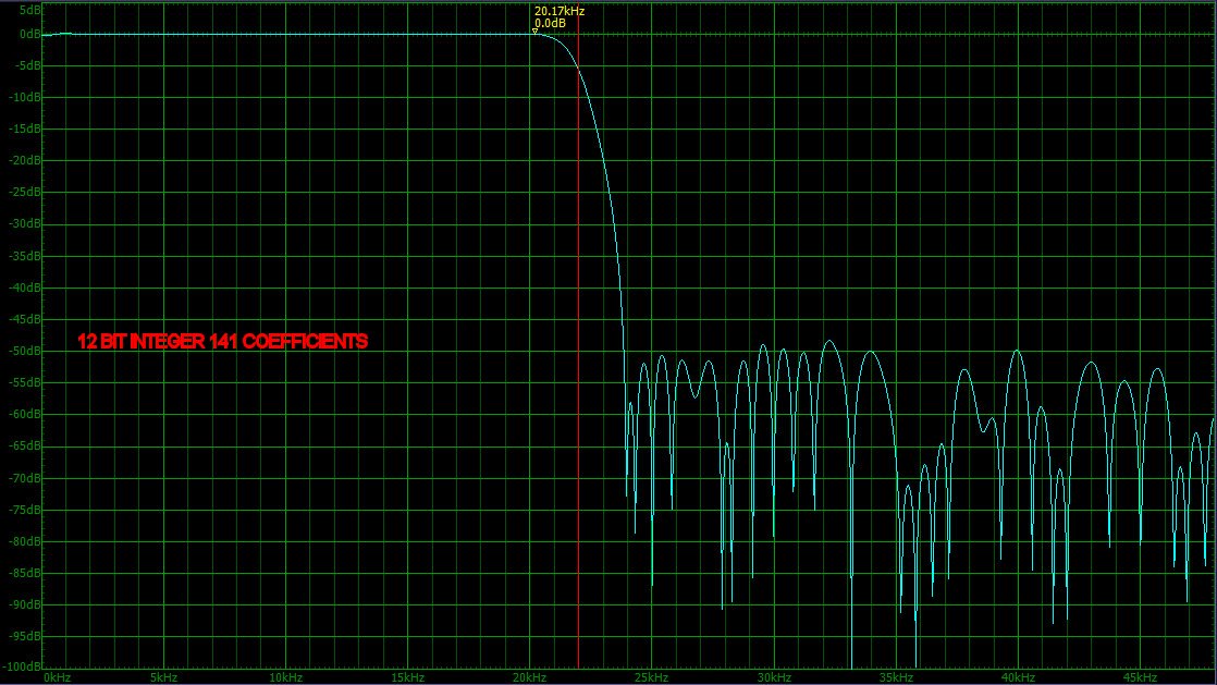

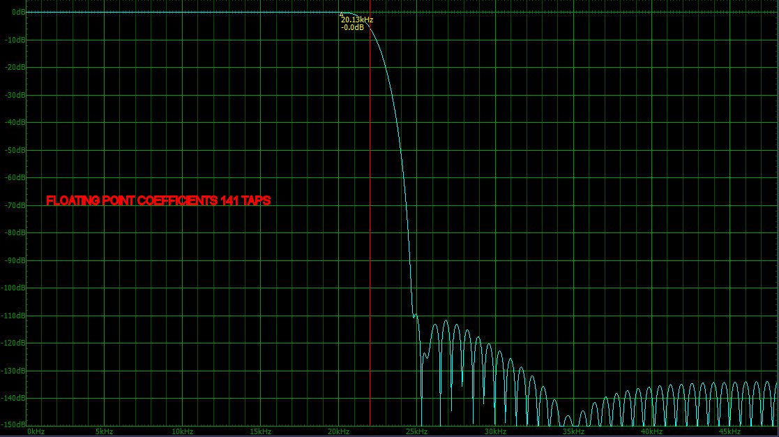

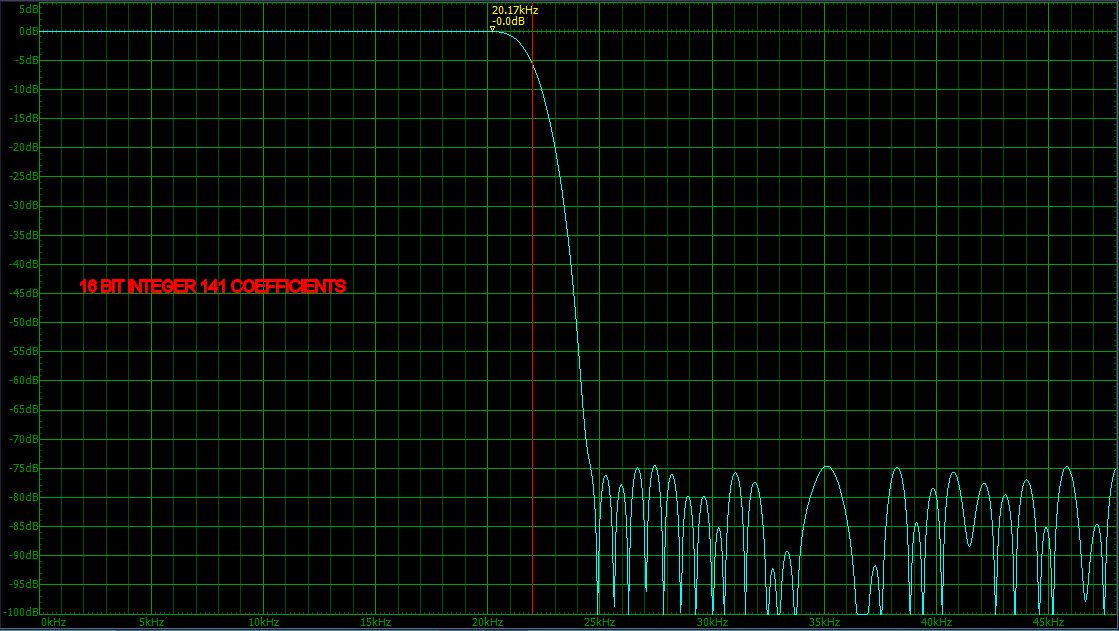

Ben
Decided to create a real integer performance FIR low pass filter this afternoon and thought I would share the results compared with the theoretical floating point coefficients. The integer performance is what you would see in the real world using 12 and 16 bit integer coefficients programmed into a microcontroller. I decided to create a low pass filter with a perfect passband up to 20KHz using 96KHz sampling using a steep stop band shelf going down at 22KHz. The sweet spot in the design tool was with a Blackman Harris window function at 141 taps or coefficients. The filter was able to attenuate all out of band aliasing down to -75dB which actually isn't bad considering that the integer coefficients are actually rounded approximations of the required precise floating point calculations.
It was actually possible to decrease the number of taps and maintain the -75dB level for the 16 bit integer design but reducing the taps simply makes the filter roll off at a more shallow rate. What we get with the 141 taps is a roll off of around 2 to 3 KHz which would be almost impossible to achieve in the analog domain. We get an additional 25dB of attenuation simply moving from 12 bit to 16 bit integers. Anyway I just wanted to share these with you because the filter design number of coefficients had to be somewhere between 100 and 150 taps and this substantiates what I wrote earlier about increasing the number of taps in the Flowcode FIR component.
- floating point coefficients.jpg (120.49 KiB) Viewed 14702 times
- 16 bit integer coefficients.jpg (138.82 KiB) Viewed 14702 times
- 12 bit integer coefficients.jpg (140.33 KiB) Viewed 14702 times

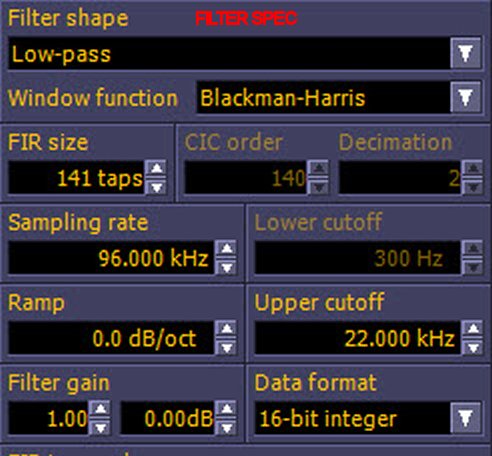

Here is the filter spec image
- filter spec.jpg (47.98 KiB) Viewed 14702 times
