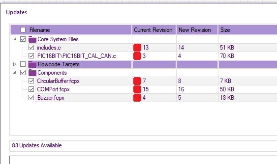

How to know which modifications are done on components ?
Before to update it's important to know clearly because some of them can be critical.
How to get the history versions and modifications
component log file.jpg (28 KiB) Viewed 14626 times

Hi Seb,
Currently there is no real way of knowing without asking us to look back at he change history, we could maybe add something into the wiki on each component page but it would be a manual process and ideally you want the information as part of the update tool.
It's on the list as something to investigate for v10.

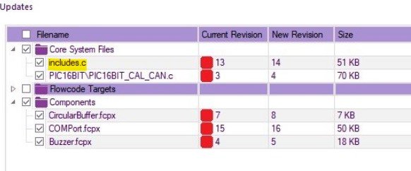

if can be implement on filename link who can open the log file will be very good.
component log file.jpg (23.77 KiB) Viewed 14612 times
click on included.c will open the log file.
Which modifications did you do on the Includes.C, CircularBuffer and COMPort ?
Includes.c - Now allows for up to 3 CAN channels instead of the previous limit of 2.
CircularBuffer - GetArray was not pointing to the sim version of the function and had an unused string return variable.
COMport - Nothing to report

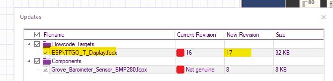

What are the modifications done on the
ttgo fcdx.jpg (18.79 KiB) Viewed 14484 times
thx
Seb
Posts: 2347
Has thanked: 650 times
Been thanked: 856 times
Re: How to know which modification are done on components?
Hello Seb,
We added an experimental microsecond option for the timer interrupts.

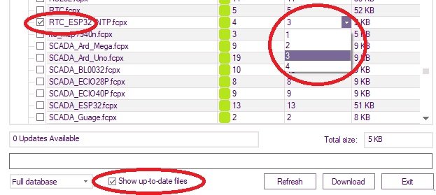

What are the modifications done on RTC_ESP32_NTP revision 4 ?

Ben, could you send me the RTC_ESP32_NTP revision 3 please.
since install version 4 , compile failed!

Hi Seb,
It's easy to roll back, once you know how ;)
Then click "Download"
