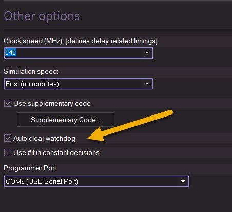

Posts: 2242
Has thanked: 616 times
Been thanked: 815 times
Re: ESP32 watchdog timer triggers constantly
This post should solve the problem for you.
viewtopic.php?p=3568#p3568
Here's the info you need should the link ever have problems.
Please note that as you are using a tight loop with no significant delays the ESP32 watchdog is kicking in and potentially causing a reset. To avoid the reset simply add this line of C code into your loop to keep the watchdog timer happy.
TIMERG0.wdt_wprotect=TIMG_WDT_WKEY_VALUE;
TIMERG0.wdt_feed=1;
TIMERG0.wdt_wprotect=0;
You will also need to go into the Project Options -> Supplementary Code and add this line to the definitions.
#include "soc/rtc_wdt.h"
