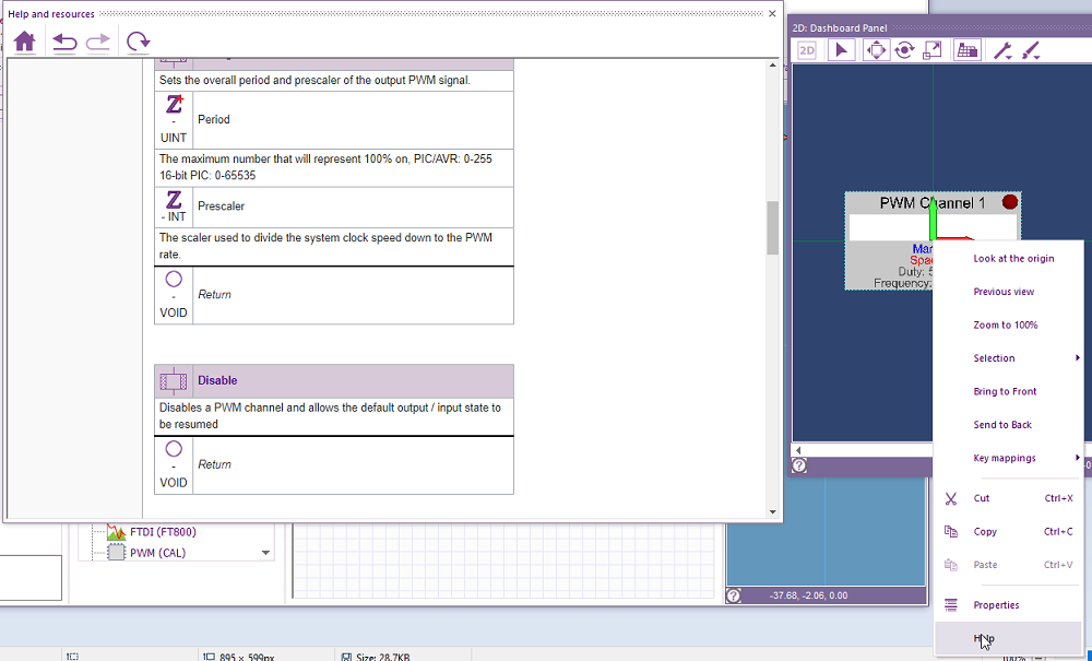

If you right-click on the PWM that's on the panel, then select help, you should see all the information within the Wiki.

As for the help, it should open a new Help and resources window within Flowcode.
Help Wiki for PWM.png (140.32 KiB) Viewed 5694 times
