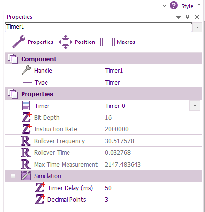

Next hurdle. For some reason, the timer returns zero elapsed time, even with a deliberately inserted 4ms delay.
Looking at the timer properties there is a 2MHz coount rate specified with no option to change it.
Does FC, knowing the osc freq, insert a prescaler to get to 2MHz?
My processor runs at 32MHz.
Could that give a conflict?
Edit: a 2MHz instruction rate implies an 8MHz clock, right.
Jan Didden
