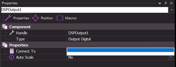

DSP-Component cannot be connected in the FC9 App Developer.
In FC9 Embeddet its working nice.

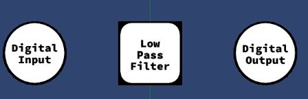

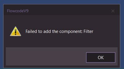

In the App Developer, when I drag and drop the DSP component, an error message appears.
Only the second time the DSP component appears in the 2d window. But it doesn't work.
Apps I've created before still work.
