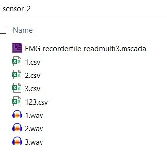

So the idea to rename the measurement data file to 1.wav; 2.wav; 3.wav
If the file name is already known, you can also write the app in such a way that first file 1, then file 2 and then file 3 is opened automatically
and the App, analyzes and saves the results automatically.
The results from the 3 files can also be automatically saved into
files 1.csv 2.csv and 3.csv
or written into a single 123.csv file
Now I have more files in different folders (always 3 files)
I copy the finished App (just a few kbytes) into each folder
And then start my batch file. (start_all.bat)

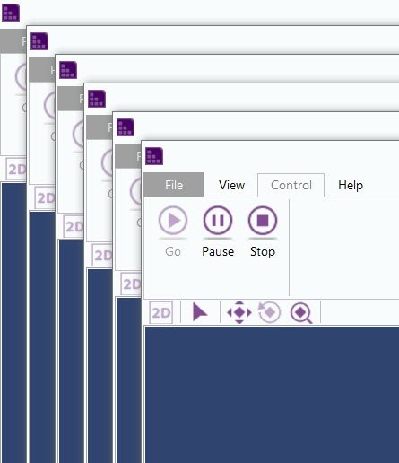

All 6 Apps are started and run at the same time
Time to drink coffee...
When I get back I quickly look at the results on the app and then close the app.
