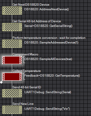

Im having a bit of a problem with the DS18B20 what i have is The node MCU ESP32 module with a TFT display connected. The DS18B20 is connected to PortA.0 and has a 4k7 resistor from 3.3V to data line what happens is it sometimes reads the temp correctly and sometimes just gives me weird readings see below.

Feedback - -0.062500
DutyCycle - 84
Temp - -0.0° C
PV - 0
SV1 - 78
SetPoint - 78
Feedback - 25.687500
DutyCycle - 59
Temp - 25.6° C
PV - 25
SV1 - 78
SetPoint - 78
Feedback - -166.312500
DutyCycle - 0
Temp - -166.° C
PV - 65370
SV1 - 78
SetPoint - 78
DutyCycle - 84
Temp - -0.0° C
PV - 0
SV1 - 78
SetPoint - 78
DutyCycle - 59
Temp - 25.6° C
Any idears on how I can sorting this problem out?

After the sample all devices command you might need to call the AddressNextDevice or AddressSpecificDevice macro to point the read to the sensor you want to read. Hopefully this should help.
You could also maybe try reducing the bit depth of the DS18B20 component, this will speed up temperature conversion and might give us a clue e.g. if a timeout is happening.
To know more I might need to see your project or a simple version of that demonstrates the issue. I am using DS18B20 devices here on a heating controller and they are working great so hopefully it's something specific and simple that we can iron out.
