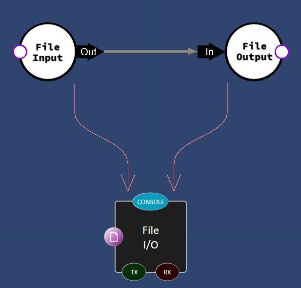

It should work that easily.
Open a file, read the array and store the array in another file.
But what am I doing wrong? The created file is empty.
App Developer from DSPInputCSV to DSPOutputCSV

Re: App Developer from DSPInputCSV to DSPOutputCSV
I've been through and had a look and managed to fix some things. In your project you might need to set the file instance between the read/write so as to not get the file pointers confused.
However in doing this I have found a potentially bigger problem we are currently investigating. I'll keep you posted as to how we are getting on.
