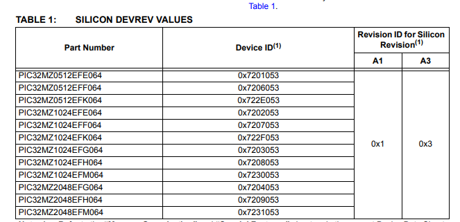

Chadb wrote:
Mon Mar 14, 2022 8:10 pm
I am using the 32MZ0512EFF and I cant' get it to program.
However flowcode is compiling with
C:\Program Files\Microchip\MPLABX\v6.00\mplab_platform\mplab_ipe\ipecmd.exe /P32MZ0512EFE064 /F"C:\Users\d_e_l\Documents\Flow Projects\Voyager Project\Pic32MZ 1st test vp 2.hex" /TPPK3 /M /OL
Since one device is 32MZ0512EFF = device id 0x7206053
the other is 32MZ0512EFE064 = device id 0x7201053
They are two different devices.
The hardware you have is detected as EFF version, but it looks like Flowcode has the EFE version only
Perhaps a new fcdx file can be added?
I will look into it.
Chadb
Posts: 73
Joined: Fri Dec 18, 2020 1:15 pm
Has thanked: 32 times
Been thanked: 1 time
Re: Pickit 3 programing issues
Post by Chadb »
Hi martin, When I typed that, it was a typo. it should read as 32MZ0512EFE064. This is the chip that I am using and the chip that I selected in flowcode. Sorry about the confusion.
The discrepancy between the two builds is probably because I was trying the ipecmd vs. using the pickit3 external programmer setting.
They both produce a similar result.
At least we are one step closer. Being able to flash a hex with mplab removes the hardware from the equation.
Chad
Posts: 2325
Has thanked: 724 times
Been thanked: 783 times
Chadb wrote:
Wed Mar 16, 2022 10:48 am
Microchip as got PIC32MZ0512EFF064 as 0x7206053 which is being picked up.
Either the chip ID has been programmed wrong by the manufacturer, the chip has been marked incorrectly or the ID within MPLAB is wrong.
Going by this:
Device ID.png (70.21 KiB) Viewed 10225 times
See attached, the latter can be ruled out.
It can only be one of the first two options.
I would suggest the chip is marked incorrectly.
80000663F.pdf
(207.72 KiB) Downloaded 670 times
