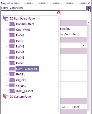

To resolve this select View, Component Properties.
Select the dropdown arrow at the top and select:
Servo properties.png (50.02 KiB) Viewed 4261 times

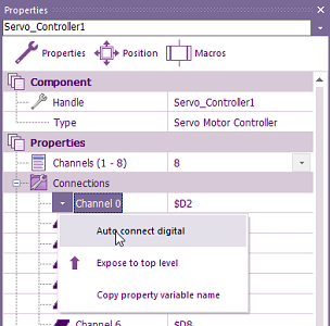

Select the window next to Channel 0, make sure Use chip references is unchecked and Select D2.
Select Channel 0 once again then Autoconnect digital:
Auto connect digital.png (45.52 KiB) Viewed 4261 times
That will assign the correct pins up to Channel 5.
Just manually assign channel 6 to D8 and Channel 7 to D9.
