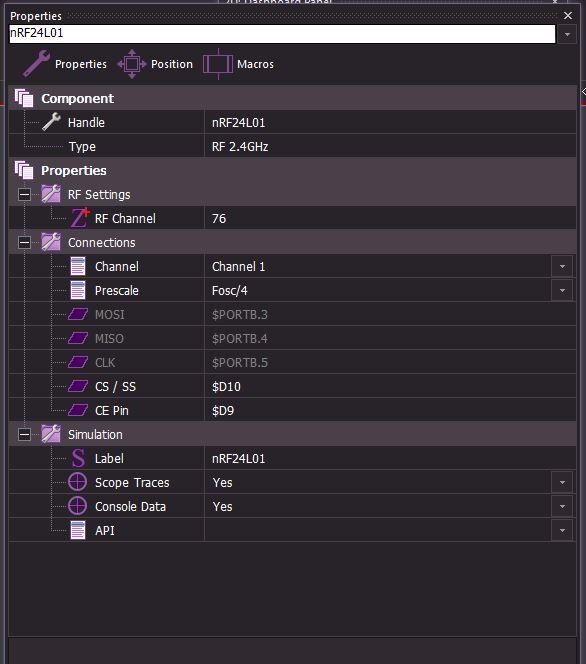

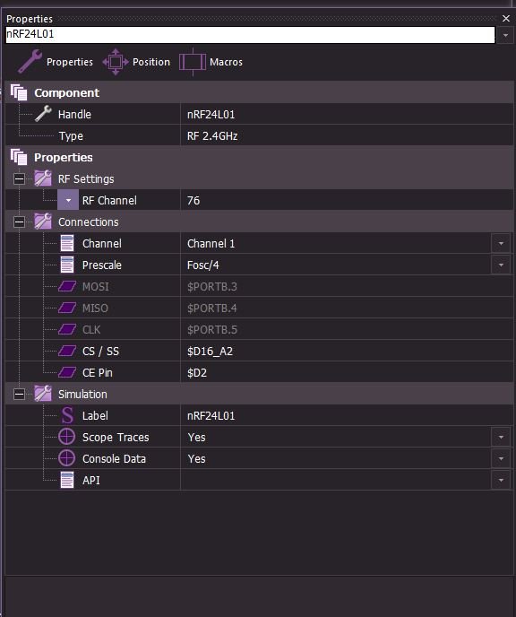

How to use the nRF24L01 module in Flowcode V9? Unfortunately it doesn't work for me.
- TX AND RX SETUP
- TX.JPG (51.24 KiB) Viewed 7677 times

Does it help if you lower the SPI clock frequency by increasing the Prescale property. 16MHz / 4 could be too fast if there are wires or lengthy traces going to the modules.
I think I still have some of the modules here so let us know if you're still having problems and I'll see if I can get them working for you.

How to set the CS/SS pins?
C:\ProgramData\MatrixTSL\FlowcodeV9\CAL\AVR\AVR_CAL_SPI.c:152:4: warning: #warning "Hardware SPI may cause a lockup in your program if Hardware SS Pin is left as an input!"; [-Wcpp]
C:\ProgramData\MatrixTSL\FlowcodeV9\CAL\AVR\AVR_CAL_SPI.c:153:4: warning: #warning "Suggest using the SS pin as the CS pin to ensure no lockup." [-Wcpp]
C:\ProgramData\MatrixTSL\FlowcodeV9\CAL\AVR\AVR_CAL_SPI.c:154:4: warning: #warning "SS pin must be set to an output or pulled high before initialising the SPI." [-Wcpp]
C:\ProgramData\MatrixTSL\FlowcodeV9\CAL\AVR\AVR_CAL_SPI.c:155:4: warning: #warning "Refer to the device datasheet for the SPI hardware SS pin."; [-Wcpp]

Hello!
I read this in the code compiler: (Arduino Nano 328)
"Important user information. Please read." - OK
"Hardware SPI may cause a lockup in your program if Hardware SS Pin is left as an input!"; - what is the solution?
"Suggest using the SS pin as the CS pin to ensure no lockup." - how to set this up?
- Posts: 2093
- Has thanked: 163 times
- Been thanked: 960 times
Re: Flowcode example Arduino and NRF24L01
You need to either use pin 10 as CS (chip select) or set it as an output.
Easiest is to use B2 as CS in the nrf code but you can output something to it instead of required.
