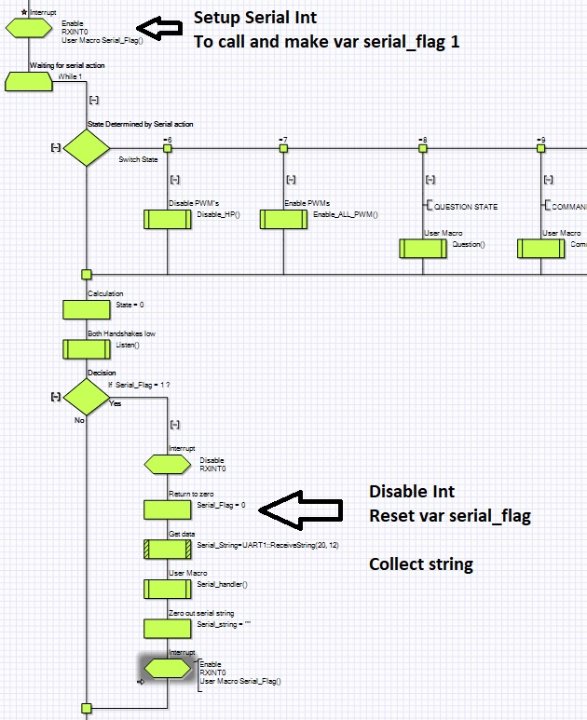

I have my serial comms working, but on occasion it seems to not work. My setup is simply to poll the serial port and use the serial string to operate.
In order to attempt to use the serial interrupt (instead), I can't seem to make it work. I have been told that gathering a string in the serial interrupt is not the method, and that I should be using a circular buffer. Studying the buffer for me is like completing a crossword puzzle. I don't have a simple example.
So I attempted a different method -
On serial interrupt signal, I simply set a bit and return. At that point, I return from the interrupt and poll the uart. Does not work, and I suspect that the uart buffer may be empty after the interrupt occurred.
I WOULD like to implement the circular buffer, but can't find guidance that meets my understanding.
I have attached a jpg file of the area I'm working on that does not perform.
Guidance would be appreciated.

Have you looked at the examples with the Wiki entry for the Circular Buffer?

The CB is certainly the "goto" component for my needs and as Martin suggests the wiki examples are a great place to start.
Briefly, enable an interrupt on RX that points to your ISR (Interrupt Service Routine). In your ISR keep things brief. You can grab a Character etc from the UART and then store it in the CB before returning.
In your Main routine you can then poll the buffer for content. You can look for the presence of a specific value / character / string and if found "do something".
Sorry to be brief due to travel. If you need an example or two I can knock something up for you later in the week.

Martin - Yes looked at the wiki, and don't comprehend it. Really wondering why I can't simply retrieve a string at uart interrupt time.

As an aside - I like to look for the termination character in the interrupt handler, and set a flag if it is found. The main loop can wait until this is set before attempting to interpret the input. The interrupt routine must be kept tight..
In a calculation block.
Flag = (.c == '\n')
Where .c is the character received and '\n' is the string terminator (so 0 or ',' etc). This sets the flag to true if the terminator character is found..
In your program loop:
Loop
If flag then process_input
Do stuff or sleep
End loop

Attached is a very simple v8 example, which should work in v9 (only have v8 on this machine). v9 provides you with many more options re USART and CB. I haven't tested this on hardware but I'm pretty sure it should work.
It has a USART, Circular Buffer and a LED. Using the Rx Interrupt to populate the CB ensures that no incoming data is lost.
After initialising, the RX Interrupt is enabled before entering an endless loop.
All the loop does is check for the presence of a keyword anywhere in the Circular Buffer and if found it will flash the Led for two seconds. Of course your loop could be doing anything and if the keyword is found do whatever you wish.
When data is received, the interrupt branches to the ISR Macro. This Macro receives the incoming character, stores it in the CB and then, if desired, echos the data back out on the USART (this is a way to check what is going into the CB and can be deleted if required).
I've have set the keyword as "Test" but it could be pretty much anything.
If you connect a PC running Terminal or such like you can send in any data you wish either character at a time or as a string of characters. When the combination of T, e, s and t (Test) is received, irrespective of where in the buffer, the program will branch and flash the Led. If you send 123Test the Led will come on. If you send Test1234 the Led will come on. If you send test it will stay off. If you send tesT it will stay off. The keyword has to match exactly and as mentioned earlier it does not matter where in the buffer it is.
If you know exactly the phrase or combination you are after, then using just a keyword can make things very simple. However if you need to look for data that varies, then there are better ways to search/parse the buffer.
As Martin said in the previous reply, you could send your data and terminate with a predefined character or sequence. You could poll the buffer for this termination character and if present parse the CB for your data.
I can give you an example of how you could collect data from multiple devices if you wish, by polling the CB, but as mentioned earlier v9 gives you far better options when working with the USART and CB, so if you want an example I'll do it once back on v9.
