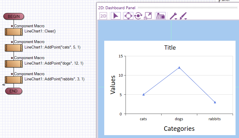

Hi Flowcode Team,
Is there a way to get the line chart componet to start at 1. The first sample seems to start at 1 and then the second sample is also 1.
Is this a bug or is it because it starts at 0.
Also would be nice if you could show on line chart some stats like Min, Max, Average Sample value.
Thanks,
Wayne M :)

Hi Wayne,
I'm not sure what you mean. Here's what I get when I create a simple project:
2022-04-20 09_56_01-2D_ Dashboard Panel.png (70.97 KiB) Viewed 3185 times
Could you please send an example project showing the issue?
And thanks for your stats suggestion. I'll have a think and see what is possible.
