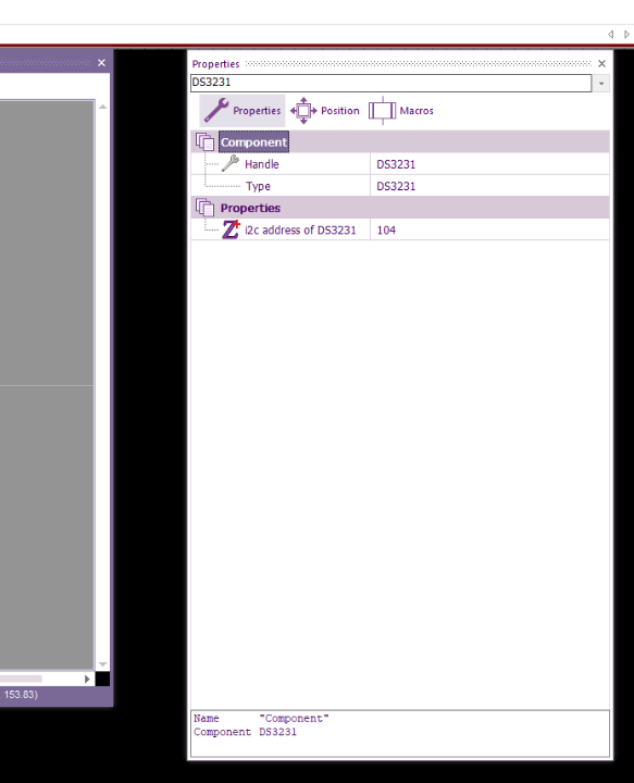

nice component nice job, I would like to test it but the properties of the I2C connections and the Baud rate are not displayed and I cannot test it, can you do something?

thank you,
I copied the file and now the properties appear, but it does not compile from error at point 2/7, same prg with original FC component no error

I'll try with an esp32. The old component was compiled with v8 which might make a difference?
Can you post/pm your code - and I'll see if I can get it compile smoothly..

sorry I saw your message late, the DS3231 component is in the center of the 2D panel cross, unfortunately it is not displayed correctly

Okay - I modified the couple of places that the esp32 compiler was complaining about (it is very picky!)
The component doesn't simulate or display nicely on the 2d panel (if anyone would like to assist?) I will convert it to use transaction i2c handling tomorrow... then it should work on the chips that don't support 'byte' handling (ARM and possibly others??)
So your code should now compile okay.
