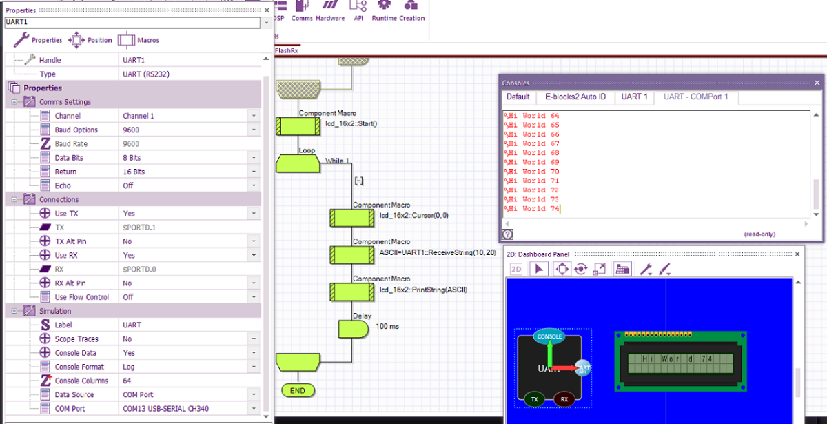

Injectors have been removed with V9, so now you don't have to add additional injector components to receive data.
Here are my properties to receive injected data:
I used the attached flowchart to send the data to the target device then the send part was disabled.

One way to do this (and I'm sure there must be an easier one....) is to use a virtual com port.
For example - I used the free trial from https://www.eltima.com/virtual-com-port-windows-10/
Then I create a pair of com ports (I had 13 -> 14) and connect FC Data source com port to 14... (it takes some time for the ports to show up if FC is running whilst they are created)
Then open 'putty' (or your favourite terminal program) on COM13 Then you can type whatever to the simulation com port (note that this step isn't required if the receive program is running on an MCU - as you can connect directly using 'putty')
The problem here is that the eltima software is expensive (there is a 14 day free trial). There are other virtual serial port programs available (some free) - though I haven't tried them.
Note that the 'logic' of the sample above means that the string received must be received in 10ms (so type fast) - or change the timeout on the ReceiveString function - or receive the data to a buffer and look for a 'termination' character (newline or no. characters received etc)

Re: Serial Simulation
With the attached Flowchart, you can type into the Human Interface RX Queue of the Console, while the simulation is running.
The LCD will show the chars as you are typing.
