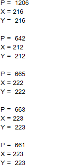

This is the results i get when I trigger the interrupt manually while touching the screen, it only seems to be reading one access. As I have the screen turned 270 degrees it looks like the x access is the missing one.

The x y problem is solved, In the test program I noticed that I was sending the x value to the y when printing to the UART
I will try work around the interrupt problem for now.
