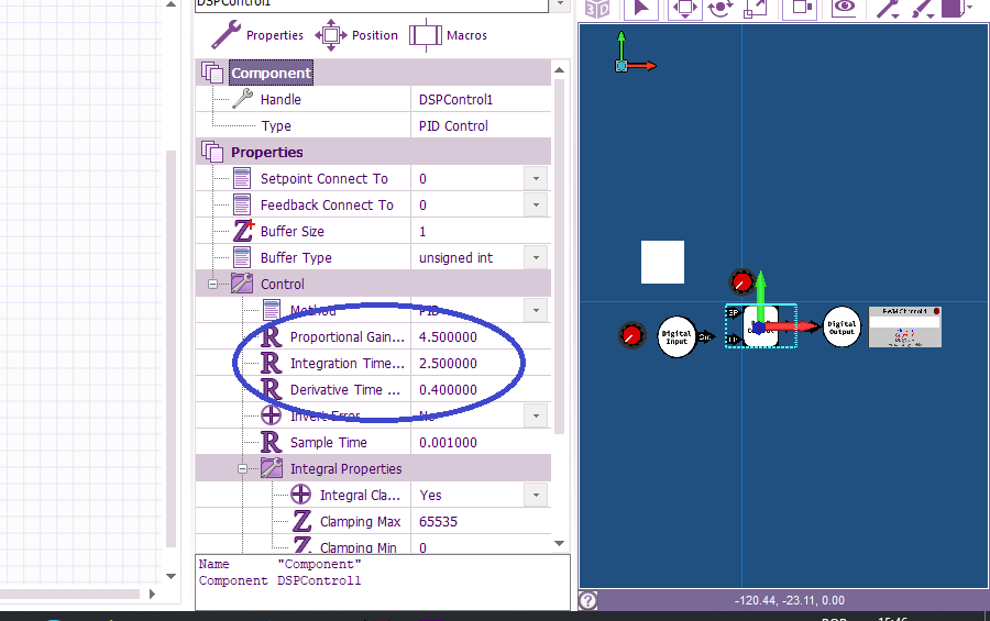

Hello. I'm trying to do some tests using the PID control and I have some doubts. I downloaded the PID example from https://www.flowcode.co.uk/wikiv7/index ... _%28DSP%29 to use it. I want to build a PID control that I can change the variables (P), (I) and (D) without having to go to Flowcode and rewrite the microcontroller with the new values. My question is: how can I use variables to do this? In the properties box I could not use variables, only numbers, as shown in the screenshot below. I would like help with this.

If I understand your request correctly, you wish to change the values of P,I and D during program execution? If so you can simply drag a component macro on to your chart, then select DSPPIDControl and from the submenu select ChangePID.
You can then use variables to set the parameters.
