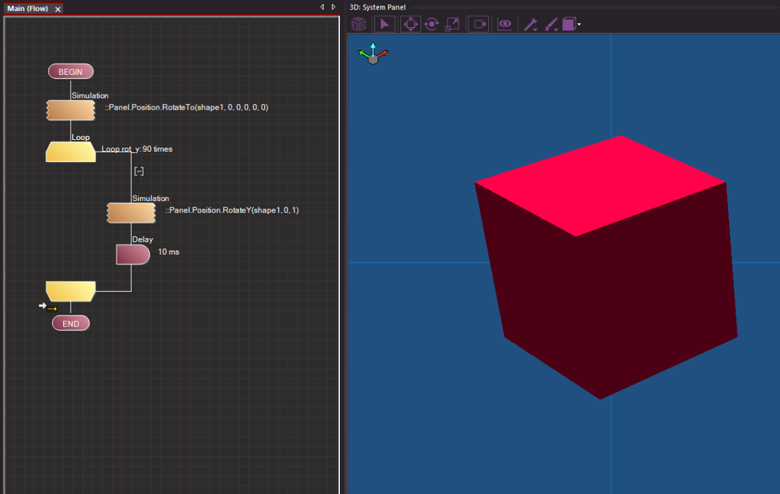

App developer How to rotate a 3D cube?
- cube-move-2021-01-11_17-59-37.png (110.99 KiB) Viewed 14273 times

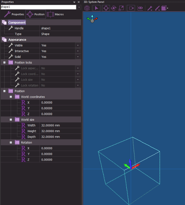

Re: App developer How to rotate a 3D cube?
Hi Stefan,
You can rotate objects in simulation and in App Developer projects using the various "Rotate" simulation macros. Add a simulation macro and look at "Built in functions...Panel...Position".

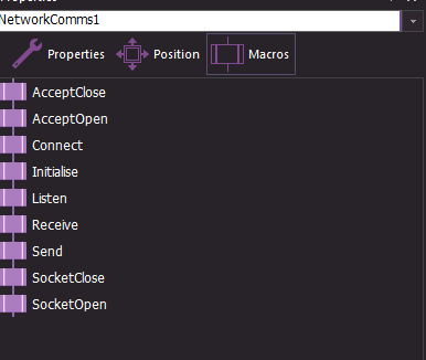

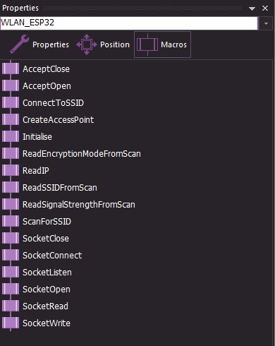

Ok for the App developer I have to use Network Comms.
In the forum I saw wardelder is using Network Comms on the ESP32
https://flowcode.co.uk/forums/viewtopic.php?f=5&t=115
But for the ESP32 program is not clear if Network Comms or just the Wlan_ESP32?
Both shows socket..
The way it goes is the network comms component provides a general purpose interface for networking which includes simulation for Flowcode and App Developer.
This then can be linked to specific hardware interfaces e.g. the ESP32 WLAN or the ESP8266 WLAN to provide an embedded solution with a common socket interface.
You can drive the network comms component yourself or you can use it with library components such as the Modbus TCP, Webserver or other components designed for use with it.
I hope this makes sense.

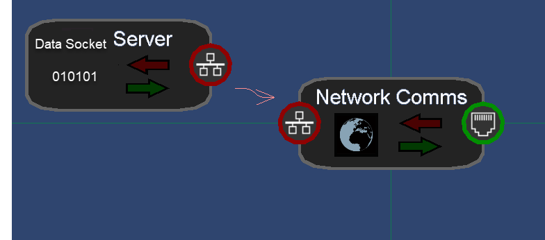

Ok the network comms component is very good.
What about a new component "Data socket server".
Something similar like the webserver but it's serve instead of HTML Code one or various data-buffer with 512byte (or much more).
This data buffers can be updated (changed) at runtime.
I suspect the socket client in the app developer can download this data very quickly and easily. Of course, many socket programs can download this data regardless of whether it is C #, C ++ or Python

Hi Stefan,
I like it it's a great idea. Would the data socket be able to act as both a server and client or would we have two seperate components do you think?
The DSP components have a Multiplex and Demultiplex ability which can pack up seperate streams into a single data array and visa versa. Could be useful or maybe we can find a way of doing this in a more static form so we don't need DSP streams.
I think before I dive in I'd lke to sniff around the possibilites and hopefully make something very useful
Modbus TCP is a similar thing but the data is pre-arranged into addresses. Might be worth you having a look at this while we work out the details.
