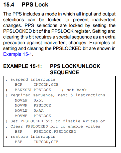

I did reset the config bit that allows only a one-time redirection (for instance at init, but not when the program runs), but it could be that PPSLOCK is on at default.
Edit: it should be unlocked at default, according to the data sheet. And the unlock sequence didn't do the trick
BTW How does one do a Banksel in C? asm Banksel PPSLOCK throws an error.
Jan
