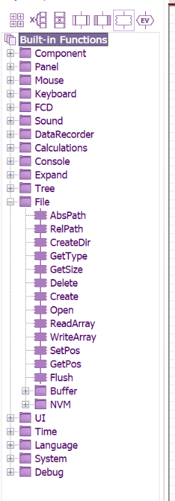

However - App developer does have file operations - and it would be easy to use these to set the position and write SampleRate (note that fputs takes a 0 terminated string - is sample rate a string?)
You can use Open, SetPos and WriteArray for example.
On an mcu - there is no disk (sadly open etc are not that device independent) - so you 'll need to write to EEPROM or SD card as appropriate.
FC doesn't seem to allow C code blocks in App developer files. So if that is the target then no go.

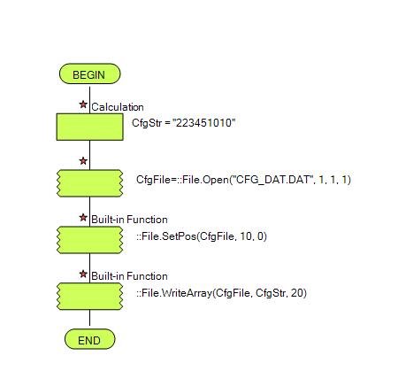

Should use Length$(CfgStr) to write out the string (or Length$(CfgStr) + 1 to include the 0 terminator) Otherwise you will get some 'cruff' from the uninitialized memory locations
You've used setPos to set the position to 10 in the file - From can be ::File.Seek_begin, Seek_curr or Seek_end (click on the little 'triangle' at the end - I guess seek_begin should correspond to 0...
However - if the file is empty (newly created) - seeking to position 10 may not work (should it pad the file to 10 bytes ?) - so it will probably work as you expect on the second run - when there are some bytes in the file.

Re: Using a C code block
