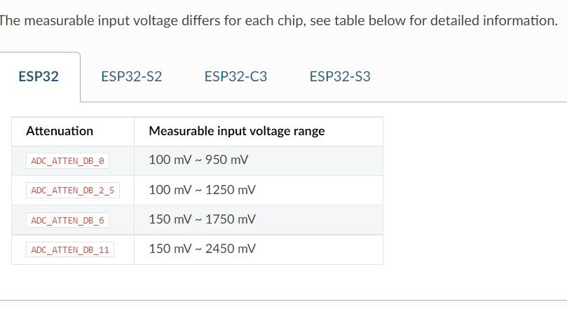

Is it possible to add a command for all the AD converter from the ESP32 to use analogSetAttenuation?
https://espressif-docs.readthedocs-host ... /adc.html#

But it is a little confusing what the ESP32 pico delivers.
In order to get to the maximum I have to apply the following voltage:
Vref Vin
950mV 1.1volts
1250mV 1.39 volts
1750mV 1.89 volts
2450mV 3.2 volts
I'm not interested in the small errors at the moment, but why is
for the 2450mV reference 3.2 volts necessary?
But even worse, I should actually have the 3.2 volts, but I have no idea why this is already working...
