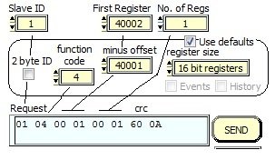

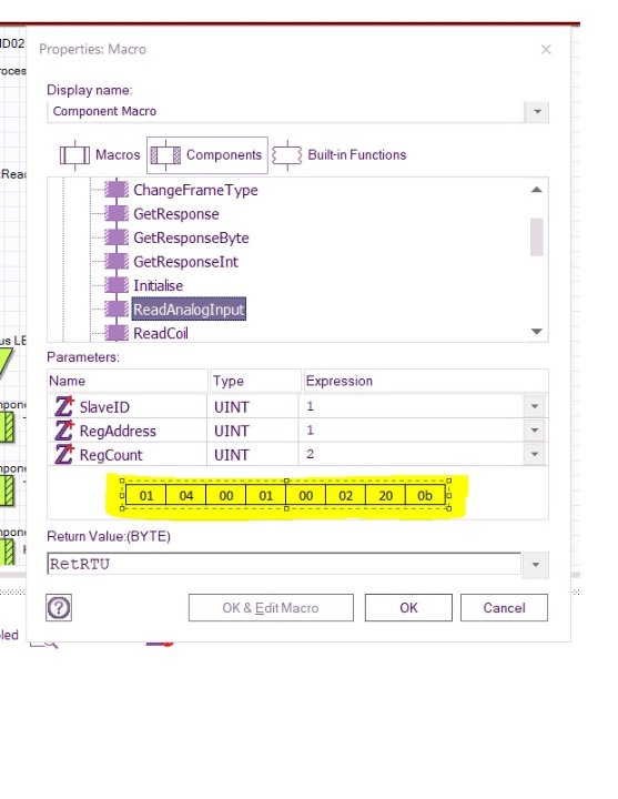

Anyway, I digress, the main issue is that there is a bit of a discrepancy as to what functions are called, https://www.simplymodbus.ca/FC02.htm has function FC02 as read input status where Flowcode has it as "Read input register" and then "Read Input register" FC04 which is what I needed is "Read Analog Input" in Flowcode and this is not even in the Flowcode web help from what I could find. I only found this out by changing the code, looking at the logic analyser and then changing until I got the required result. There was also a bit of confusion with the difference where Flowcode starts at 0 which the following suggestion would help, Modbus does not make it easy in the first place.
A suggestion, why not have a box in the configuration which actually shows the message that will be sent, this would have saved me days of hard work.
Modbus suggestion.jpg (52.24 KiB) Viewed 4200 times
This is done in Simply Modbus Master and made life so much easier when I was struggling to make sure the device originally worked.

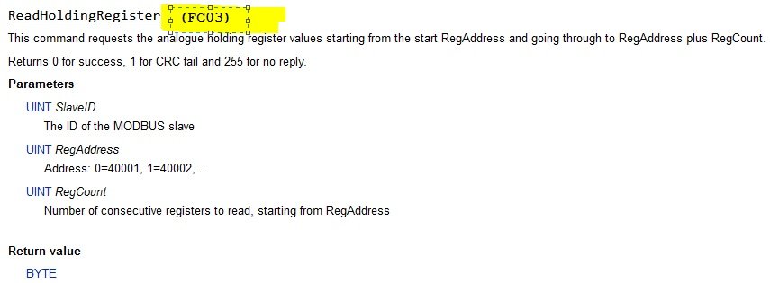

Amother suggestion would be to have the function in the help text.
Help suggestion.jpg (31.77 KiB) Viewed 4200 times
