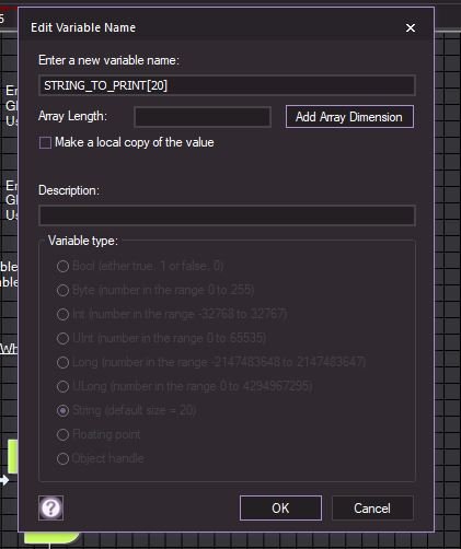

What is make a local copy of the value used for?
Amtor
Posts: 60
Joined: Thu Dec 17, 2020 4:35 pm
Has thanked: 21 times
Been thanked: 16 times
Post by Amtor »
What is make a local copy of the value used for.
A value still gets passed into the marco being called and appears as a local value even if the box is not checked.
I may be going senile.
Thanks.
Mark
local copy.JPG (33.89 KiB) Viewed 1946 times

Re: What is make a local copy of the value used for?
Post by mnfisher »
Strings can be passed by reference or value - reference just passes the address and any changes made are passed back.
Make a local copy does exactly that (so passed by value)- so any changes are kept local to the macro.
Note that the box is 'checked' but not selectable for arrays but these are all passed by reference.
Making a local copy is slower and should probably be avoided in most cases.
Post by Amtor »
Thanks very much.
I seem to remember something not quite working as I expected once, when I had that box checked but can't remember what now.
Anyway I'll leave it un-checked it's too advanced for me.
