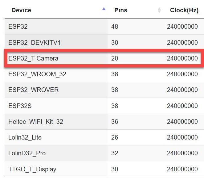

Hi Martin
I'm not sure what hardware you're using.
I found a module with 20 pins in the ESP32 Pack from Flowcode under Supported Devices.
But what hardware is that with 20 Pin?
There are various small USB modules to program the ESP32. Some also support the reset pin. You no longer have to press the reset button
Which module is that?
