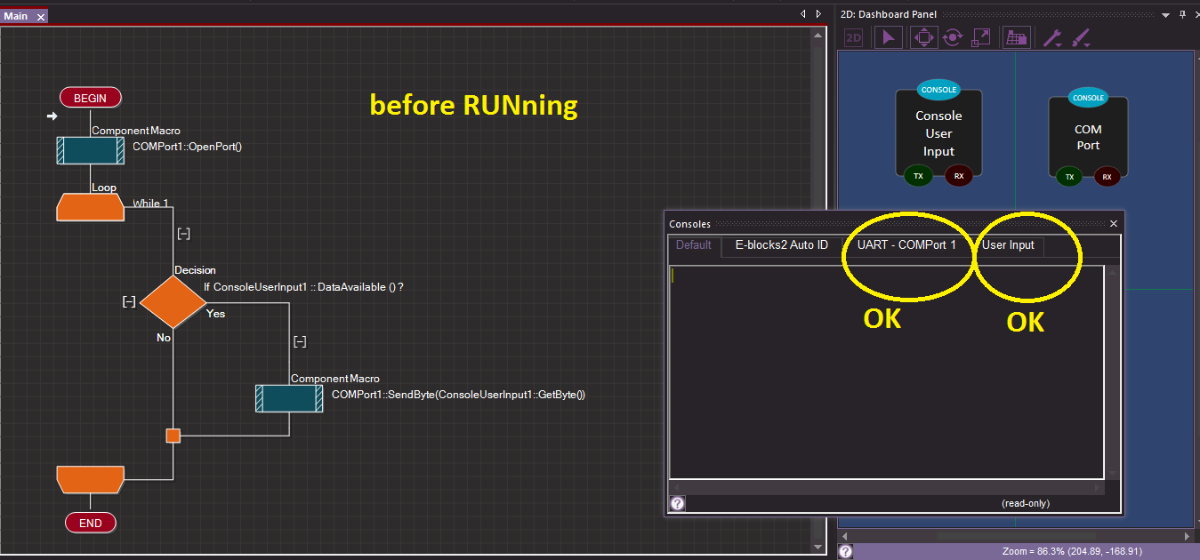

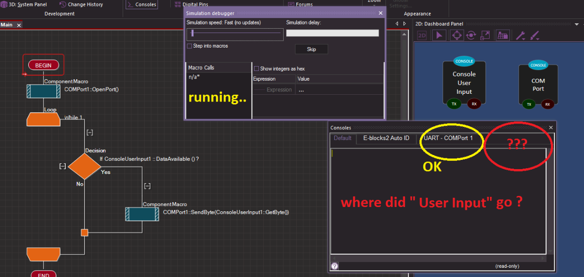

Hi FCUsers ! I have 2 PC´s with FC9.
In one of them I can see the two TABS ("Uart-ComPort1" and "User Input") when running, and the simulation goes ok.
But in the second PC, even with the same code on both machines, the "User Input" tab always desappears when RUN (F5) :shock:
What could be wrong with this PC ?
Thanks for any tips.

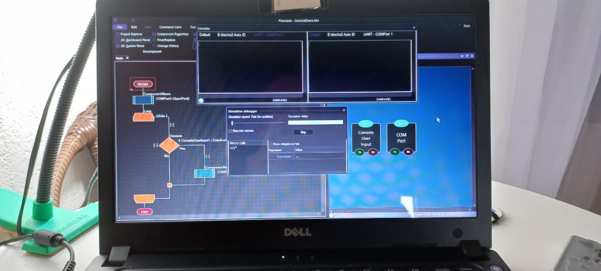

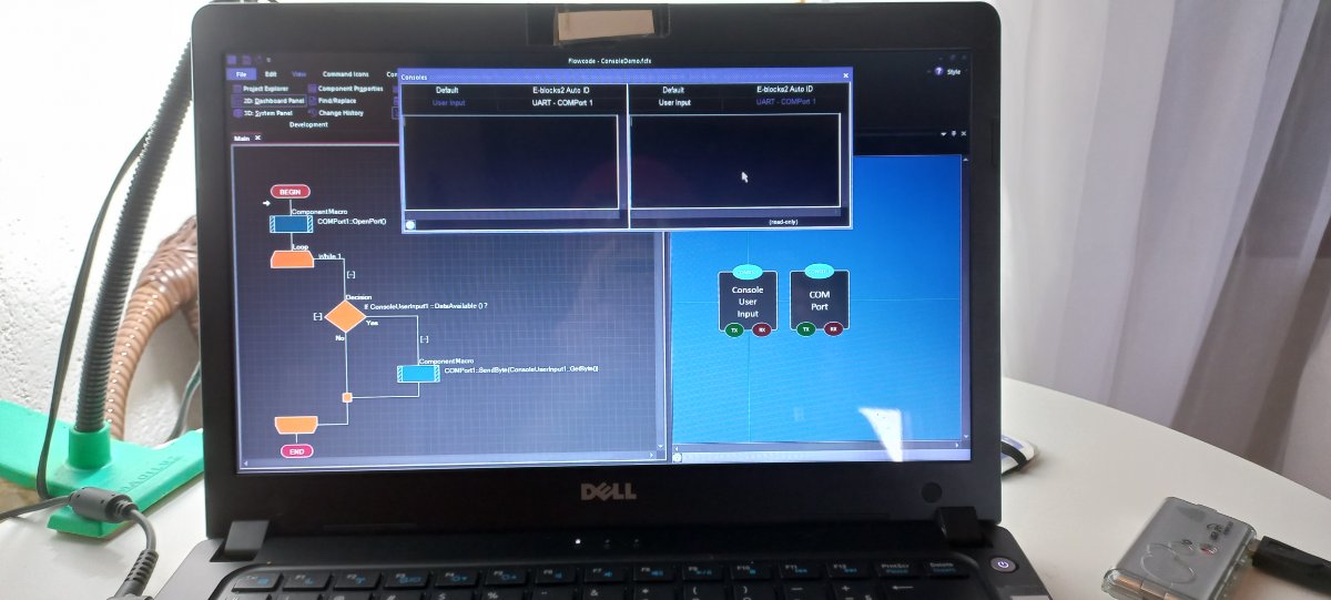

Hi ! Trying to clarify the issue with my first two computers, I took a third Win10 PC (my businness notebook) and installed a new copy of FC9 from scratch, with respectivelly updated files and components.
Just after loading the “ConsoleDemo.fcfx” code (and all successive re-loads of it), I really could see the two static TABS (“Uart-ComPort1” and “User Input”) on Console.
But for my surprise, always when RUN (F5) the “User Input” tab are still disapeering, althought “Uart-ComPort1” tab remains.
My impression is that Console only runs satisfactorily on my FIRST PC, that haven´t updated the FC9 CORE SYSTEM. The two others with updated cores, are not working for me.

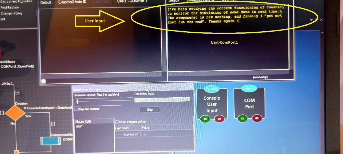

Post by ssttrragmail »
Console User Input TAB appering now ... Thanks !!
