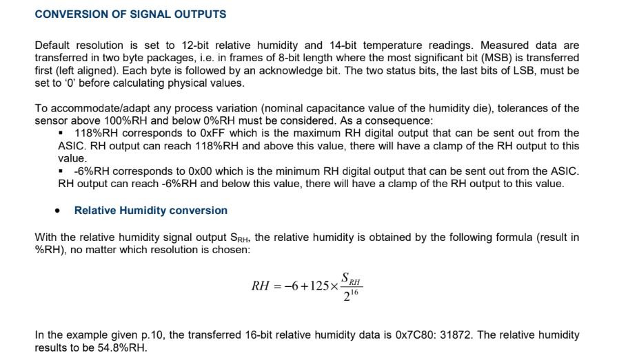

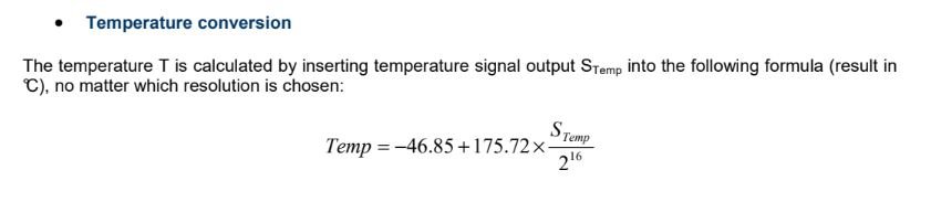

I have the sensor returning the two Bytes correctly I think but can't figure out how to put this calculation into the box.
Also how to set the last 2 bits of the LSB to zero. Would I just shift the number left twice.
I think I need to do some shifting to add the two bytes together, not just had them up.
CONVERSION OF SIGNAL OUTPUTS
Default resolution is set to 12-bit relative humidity and 14-bit temperature readings. Measured data are
transferred in two byte packages, i.e. in frames of 8-bit length where the most significant bit (MSB) is transferred
first (left aligned). Each byte is followed by an acknowledge bit. The two status bits, the last bits of LSB, must be
set to ‘0’ before calculating physical values.
Thanks very much for any help.
I expect it child's play to you lads
All the best
Mark

To set the lower 2 or 4 bits to 0 you can just do some masking, looks like shifting may also divide down the data.
TempReg = TempReg & 0xFFFC
HumReg = HumReg & 0xFFF0
Then for the calc maybe do something like this.
FloatTemp = TempReg / 65536.0
FloatTemp = FloatTemp * 175.72
FloatTemp = FloatTemp - 46.85
FloatHum = HumReg / 65536.0
FloatTemp = FloatTemp * 125.0
FloatTemp = FloatTemp - 6.0
Hope this helps.

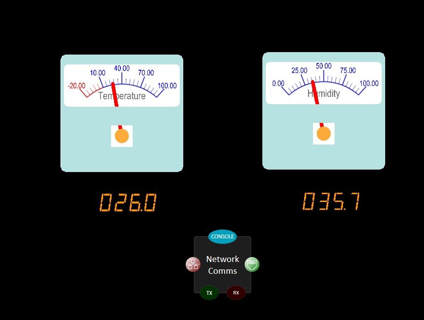

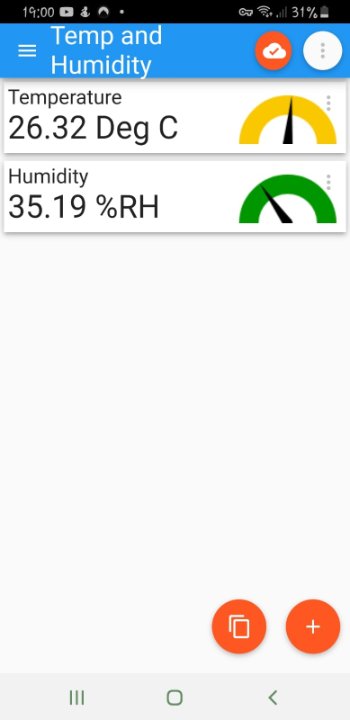

It works.
- the sensor.jpeg (88.23 KiB) Viewed 4250 times
- the pc screen.jpeg (34.43 KiB) Viewed 4250 times
- phone app.jpeg (22.56 KiB) Viewed 4250 times
