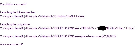

i have a problem using PICKit3 CMD:
Error PICKit3.jpg (25.55 KiB) Viewed 13413 times
Using PICKit standalone app work ok; i have also changed parameter to -V5 -E -M to use powered from programming but same error...

It looks like it's missing a DLL and so something else might need to be installed. I suspect you should install a suitable Microsoft Visual C++ redistributable, such as discussed here:
https://www.microchip.com/forums/m428272.aspx
(although you might need a later version than 2005 for PICkit3).
Also, I did find this in our old forum, which might help if the suggestion above does not:
https://www.flowcode.co.uk/mmforums/vie ... 515#p22454

i solved use of PICKit3 in Flowcode 9 using IPE method: download installer MPLABX, start installer and select to install only IPE.
Then i modified path to found IPECMD in Flowcode and added option to power from PICKit 3....

Hello all.
Will be work in FC9 the old type command for PicKit3 or not?
I tried but have a message -
Launching the programmer...
C:\Program Files (x86)\Flowcode v9\data\tools\PICkit3\PK3CMD.exe -P16F18854 -FPre release PIC16F18854 0a FC9 0a.hex -E -M
C:\Program Files (x86)\Flowcode v9\data\tools\PICkit3\PK3CMD.exe reported error code 0xC0000135

The problem solved by installing the MPlab 5.40 and selection this commands:
Location C:\Program Files (x86)\Microchip\MPLABX\v5.40\mplab_platform\mplab_ipe\pk3cmd.exe
Command -P$(chip) "-F$(target).hex" –TPPK3 -M
