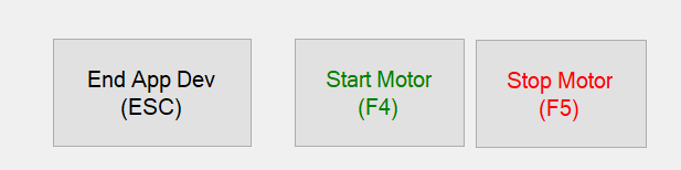

And a button can press an another button, if I press End App Dev it's press Stop Motor.

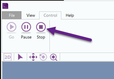

At the moment if I stop the App developer with this Stop Button, the App end right away. Its is not really good when I do a Tesla control

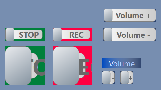

It uses switches you can press with the mouse.
They can be set up to change text with pressed etc
Take a look at this App.stefan.erni wrote: ↑Fri Jan 22, 2021 5:04 pmIs it possible to add more button components for the App developer like the switch component, but just as a press Button pressed by the mouse?

Thanks Martin, I saw how you did it. If the switch is longer than high, there is a usable picture.
Also, I don't have to move the switch with the mouse, just click with the mouse. This info is already a great help.
But if this switch should be square, I think there is something wrong.
A (push) button for my application would be even better than a switch

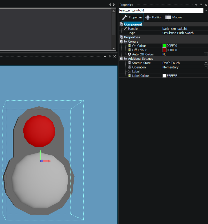

Such a push button was already available in the FC8 SCADA.
But I can't find it anymore

A lot of components are hidden, but they are usually still available. Try looking for them in the component search window.

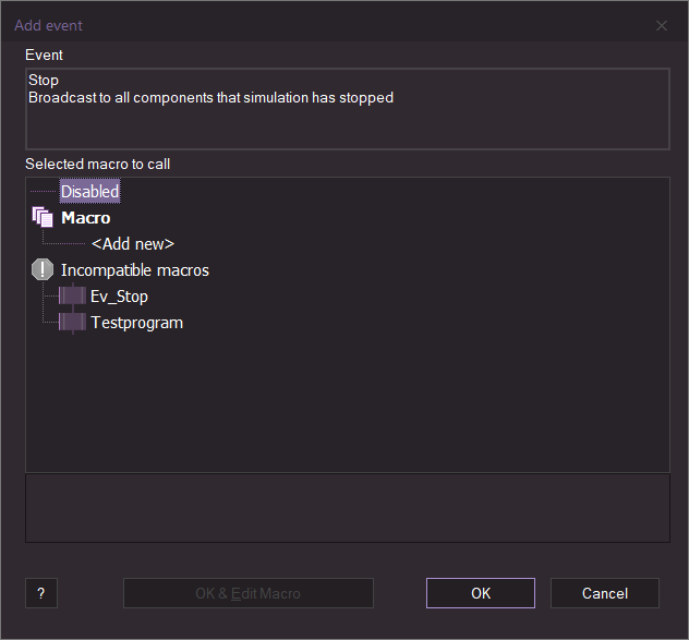

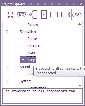

If you need to gracefully do something like flush and close comms then this is possible by enabling the Simulation Stop Event and assigning a new macro to it. This macro should then run and allow you to do any last second things before the app stops.At the moment if I stop the App developer with this Stop Button, the App end right away. Its is not really good when I do a Tesla control

I did it but it's give a problem with incompatible macro.
This push button is hidding very good. I can't found it.
Yes that a what I'm looking for.

Sorry - you are correct. I thought all components were available (but hidden). Unfortunately, only some exist for App Developer.stefan.erni wrote: ↑Tue Jan 26, 2021 1:48 pmThis push button is hidding very good. I can't found it.
I will discuss here at Matrix to see how easy it is to make them available.

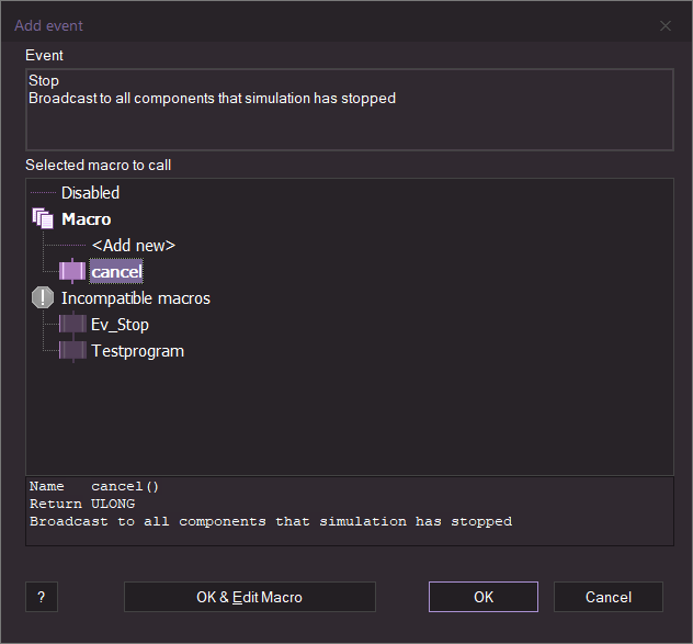

There was just a problem with the return variable missing. Now it's working perfect.
If I press the stop debug it's send lastly a stop at the machine.
Thank you.

The missing switches should be there now, though still hidden they should now be available via search.
Also not sure if this is of interest but I made a quick demo for making your own switch with images on here.
https://flowcode.co.uk/mmforums/viewtopi ... 44#p104744
