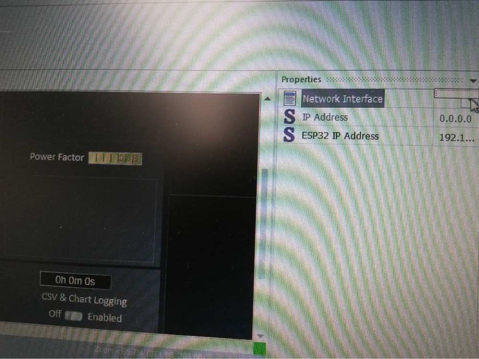

I had problems running the app developer file though. The little drop down box that you select your Network Interface wouldn't populate and was incredibly small. I could not get it to work at all. However by using the runtime it appeared to work fine. Network Interfaces populated and selected. Job done, or so I thought. Again after approximately 4.5 hours I ran into problems. This time the displayed "work panel" went "blank" i.e. no gauges etc are displayed at all but the Properties box is still shown. If I enable the Console I can see the Console Writer still updating every second as does the TCP/IP-NetworkComms1 so I assume it hasn't crashed completely.

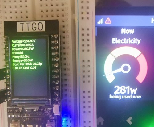

Mine was running over wifi for months, the only issue was randomly losing connection with the broker.
This is an image from my standalone version side by side with my smart meter IHD.
Power monitor vs smart meter ihd.jpg (129.38 KiB) Viewed 11686 times
The voltage in my area is always high.
The value is correct as my DMM also shows the same AC voltage.
This project is still WIP.
In the past, I reset the energy value via one of the buttons on the TTGO first thing in the morning.
Made a note of the energy value from the IHD.
later in the evening compared my energy monitor's total energy consumed with the IHD version and they were a perfect match!

I see your PF is 0.66 which seems a little surprising.
How comes?

That power factor would suggest a very large inductive load is connected and if in an industrial setting would almost certainly warrant the installation of PFC equipment. It could just be that the device is at it's lower levels of reading. My PF was 0.5x with almost nothing connected but went to a more realistic 0.95 with a load of a few amps. Switch on some non inductive loads and see if it changes significantly (e.g. electric shower / toaster or such like). SMPS can also sometimes cause strange readings due to harmonics (especially if poorly designed).

That would be true if the power is a high wattage.
As my main lights are LED which uses cap droppers and monitors have high value caps in, the power factor is normal.
If I put the kettle, toaster or oven on the pf goes to 1

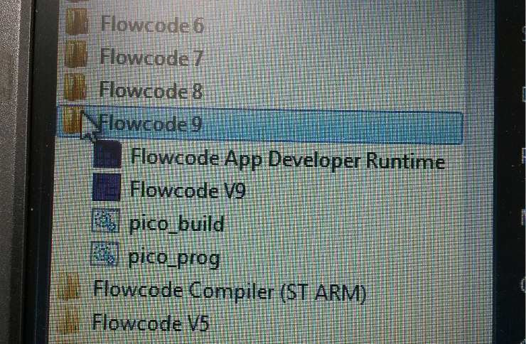

If I double click on the file it opens but I cannot select anything for Network Interfaces.
If I go to Programs/Flowcode9 and open FAD Runtime I can then load the app and select Network Interface. Same if I run the supplied runtime first.
No idea why this is the case but suspect my laptop. I've downloaded FC9 and will reinstall to see if it makes any difference.
