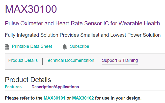

It would be fantastic to get this sensor added to Flowcode's magnetic, temp and hunidity sensors. Maxim actually produce two other variants in the family. The MAX 30100 was the first one produced but they have updated it with a newer version that I believe is shown on the schematic of the Maxim Application Note Reference Design 117

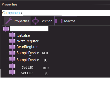

Would it be possible to create a component MAX30101 in advance with just a few commands and propertis?
So we could try to analyze HR and SPO with the DSP components.
Commands:
Init,
write register,
read register
sample RED (read long)
sample IR (read long)
SetLed RED (mA)
SetLed IR (mA)

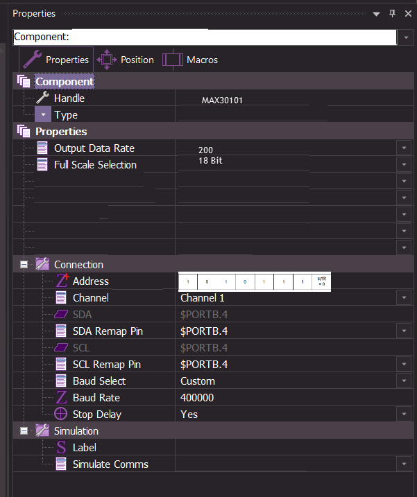

Propertis:
Datarate 200Hz
18bit (read long)
data / clock pin
the adress
Baudrate
Commands:
propertis:
Info about the MAX Numbers.
I suspect all 3 types are software compatible:
