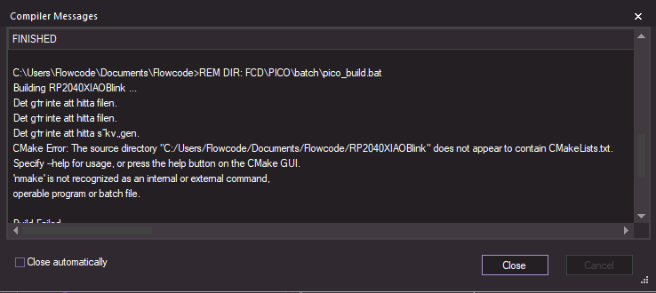

I have according the instructions for using PICO RP2040, installed the compiler software, but gets an error when compiling to hex... please se the attached png file.
Best regards Leif Söderström

Looks like you are getting "file not found" messages.
Could you try a Flowcode "Full database update"
Details here ...
viewtopic.php?f=3&t=1459&p=8324&hilit=f ... date#p8324
