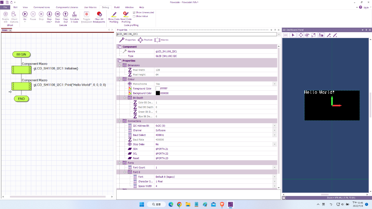

Thanks your fast reply, Ben.
Yes, Stop Delay is set to No. Check attached please. And video with slow display below:

- 螢幕截圖 2022-11-08 12.46.57.png (187.5 KiB) Viewed 5041 times

Since ES32 has I2C that can be remapped to a choice of pins, can you try changing Channel from software to Channel 1
Software selection will be much slower.

Hi, medelec35.
No reaction to SH1106 I2C if in Channel mode. Only software mode can drive the LCD to initial and pring.

What value of pull up resistor do you have?
It could be the pull up is too weak and so at higher speeds the display is not getting clean signals, this might explain why software mode works but hardware mode does not.
I would recommend pull up values of maybe 1K-4K7 to see if this helps at all.
Actually scratch that it seems the component needs an update to use I2C transactions, working on it now.

I've now pushed an update for you that should allow the hardware I2C channels to work correctly with the display.
Please go to Help -> Library Updates to get the latest version of the component.
Let us know how you get on.
