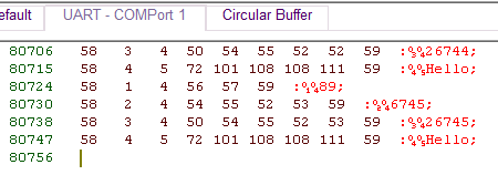

The consoles are proving very useful within App Dev, I have UART and Circ Buffer console tabs.
Is it currently possilbe to have a user defined console, much like I can place a breakpoint for bedugging.
So I could insert a 'Console' request at a given point in the FC and during simulation all data that flows through that point is displayed in console format?

Interesting, I think I have miss interpreted the consoles or at least I only use them in a very limited way.
typically I get a stream of raw data in my console view. My assumption was that this console feature was a sampling of the raw data stream passing in/out of a component and was hoping I could achieve the same sort of thing by having an effectivly empty component but that still allows sampling/viewing of the raw data but at a user perscribed point in the flowcode.
All sounds quite different to what you are both describing, to my ears at least.

I've created a new Console Writer component that allows you to easy create a tab on the console window and add content to it. It's a text only version at the moment so please let me know if you would also like to see a binary data equivalent of the component.

I've been using the console writer for a couple of projects and its a helpful tool. Would it be possible to put a 'number' version on the (ever expanding!) job list.
It would help to be able to 'sample' values and get them written to a streaming console type window.
Decimal byte and integer values is the main aim but hex and bin representations could be helpful as well.
