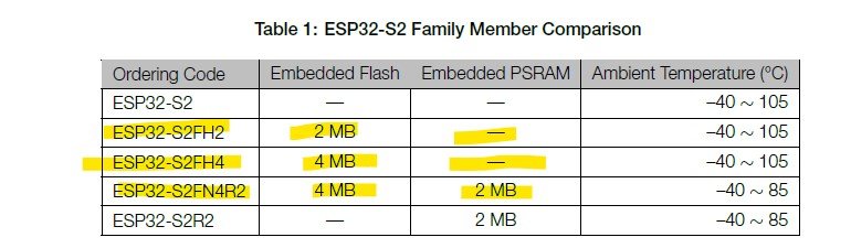

We have a customer order and we need to use these Soc's ESP32-S2FH2, ESP32-S2FH4, ESP32-S2FN4R2, it's same family only embedded flash and PSRAM change. see below.
Could make ASAP the FCDX for ESP32-S2
Thx for your prompt reply, it's urgent
ESP32-S2 FCDX request
