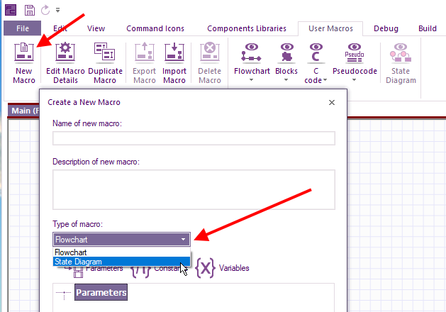

The "State Diagram" button on the toolbar allows you to access state diagrams that have already been created. To create a new state diagram, select "New Macro" from the User Macro menu and select the appropriate type of macro:
create state diagram.png (39.05 KiB) Viewed 13421 times

Steve -
Thanks. I did read the WIKI but failed to get where I was going.
Off I go into State land.
