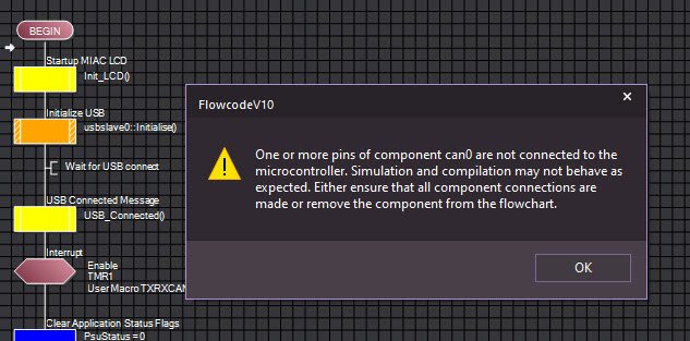

I appologise as I am not so sure how the new panel structure is working in v10 however I have a application which was originaly coded in v8 then later upgraded and maintained in v9 now I have to do some changes to the application and tried to import it into v10 (it is an MIAC application)
importing the application into v10 no issue seen however before I do any changes I tried to compile the Fc chart to makesure all is as it should be then I got an warning as below

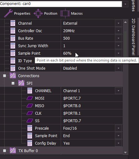

I then checked the can0 properties and it seems the pins are connected as below

I noticed in v10 the MIAC is 3D panel component now and the import placed it on the 2D panel not sure if this is causing the error/warning

It seems like the MIAC component uses mostly 3D components but the display is a 2D component. So the MIAC component will work on the "Legacy 2D Panel" but will not on either the 3D panel or the new 2D panel(s).
So I think the MIAC component will need to stay on the Legacy 2D panel. I have moved the other components to a 'normal' 2D panel in the attached.
The Legacy 2D panel is normally not available for projects in v10, but it can still be used. It's just that we recommend using the new 2D panel(s) where you can.
I do see the connection problem with this project, and this might be a bigger issue for you. I think maybe the new CAN component does not support the old MIAC component. Ben will know more about this and might have a suggestion on how to use the MIAC in v10 if it is possible.
