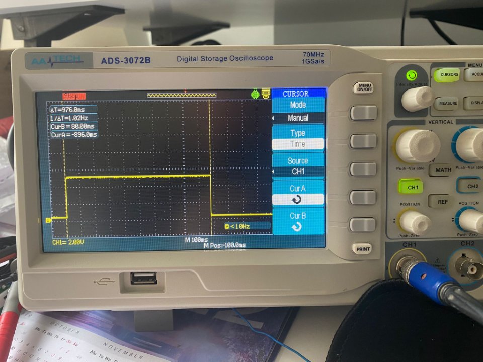

Re: DS18B20 x2 Ports x2 One Wire x2
Yes dear Medelec;
Dt=976ms There's a 25 ms difference compared to the oscilloscope.
- WhatsApp Görsel 2023-12-01 saat 14.50.05_800d029b.jpg (115.95 KiB) Viewed 10438 times
