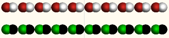

I tested a strip of these with an esp32 - and after a SetAllLeds(color) - Refresh - I get a multicolour strip (the strip I have is 120 LEDs in 60 pairs) - and I notice that 'pairs' are identical - but the colours of the pairs seem to be 'random'. I'll have a play with the oscilloscope and see if I can see what's happening here.

After a bit of fiddling - I got the LEDs to work...
So my strip seems to be GRB rather than RGBW - and the LEDs addressed in pairs (so 60 pairs length rather than 120 individually addressed)
I created an 'experimental' program than lets the user choose data format and bits per pixel. LEDs now glowing happily :-)
Note that it stores the pixel data as a long word in the order to send (MSB first) - so calculates the colour according to RGB order. I don't have an RGBW strip to test - so maybe someone could try (SetAllPixels might need a tweak, and set properties)
