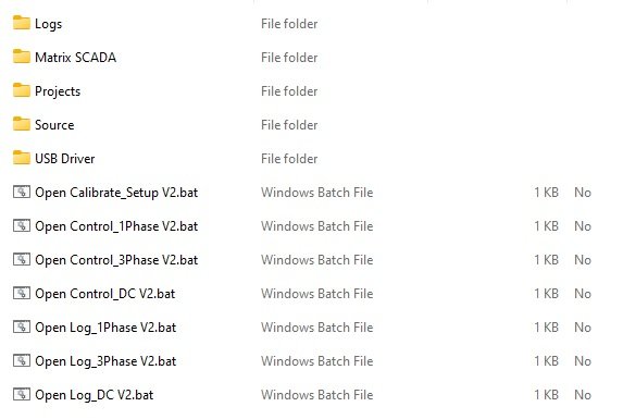

The files from the EM software should look like this.
The .csv file is inside the Logs folder by default. Logging can be disabled via the properties pane on the right hand side. You can also specify the location of the .csv log file. This file needs to have write access if you want to be able to save your data.
One thing to check is if the files have been extracted, they might not work correctly if still inside the .zip file.
