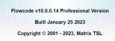

Can you please try compiling with the original v10 EXE and see if that fixes the problem. If it does, please post the v10 .c and .h files that work and I will compare with the v10 files that do not work.
I will send a PM now with a download of the original EXE as this is easier that re-installing v10.

I have perform at test as you recommend, but still the same result, nothing on the display. Strange. As I said before update to v.18 I have manage to compile with FC10
As you see it is a project I work on and made in FC9. After I get FC10 I want to continue the project in FC10 but only once :?:
