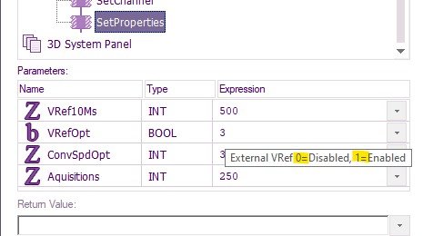

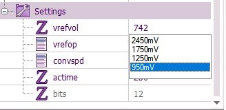

For pot_panel component, the macro SetProperties doesn't change the properties of the component. (At least VRef10Ms parameter).
VRefop can be only 0 or 1
but can be 4 different values in Components properties 950,1250,1750,2450
Convspeed can be only "Fixed" in Components properties ( may be it's normal, I don't know)
so which value to add in SetProperties ConvSpdOpt ?
