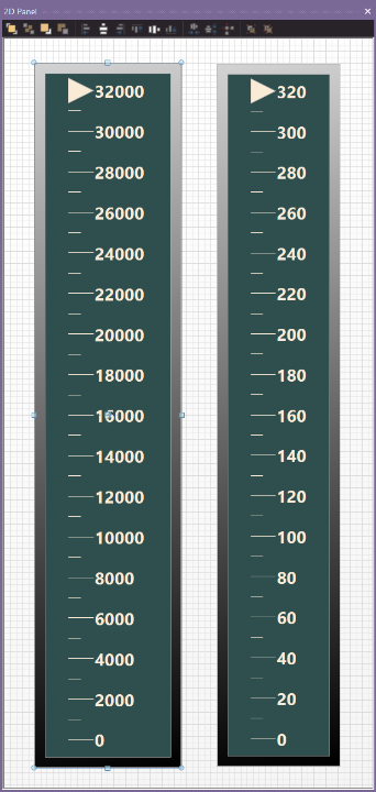

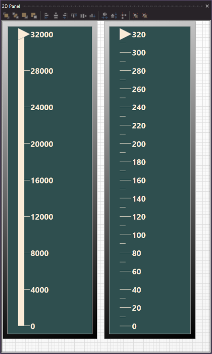

I would like to display almost all positive values of an integer on a gauge. I would like a scale from 0 to 32000
Every 2000 a big dash and a text.
In between a small dash for the 1000
I can't set the scale for 32000 like the scale for the values divided by 100.

Try:
  • Minor Tick Step = 1000
  • Major Tick Step = 2
Minor Tick Step determines the spacing of the lines. Major Tick Step determines where the numbers are shown.

Hi Stefan,
In the gauge properties use these values.
Minor tick step 1000, major tick step 2. I think you had these values backwards.
Aha - Steve beat me to it :lol:

Hi Ben, Hi Steve
Thank you very much. Now I understand
Minor Tick Step 1000: One tick every 1000 units
Major Tick Step 2: every second value has a long dash and a number.
So it is best to define the minor first and then the major.
Sometimes things are easy when you know how..
