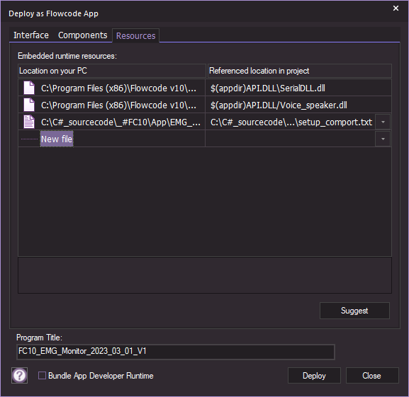

In the App simulation realspeak works perfect. A very good sound !
When I deploy it on the same computer, realspeak is not working in the deployd version.
Do I have to add some more files for deploy? Or is it not correct how i did it?

It looks the component has a hard-coded location for the DLL that in not correctly set in the App Developer Flowcode Runtime. We may need to create a new component for you.

It's solved now. But you will need a new build of the runtime exe. I will hopefully get one out this week in a core update.
